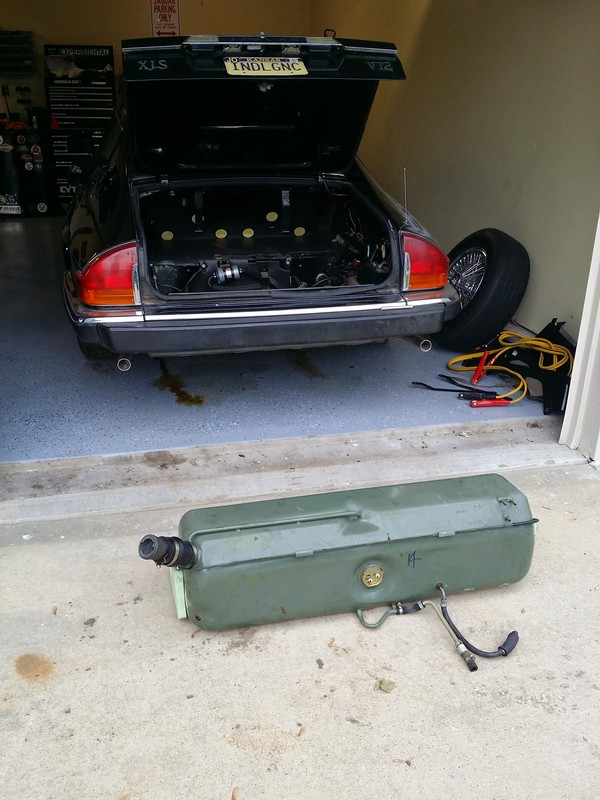

My car sat for a while and had all kinds of rust in both tanks. I took mine to a local radiator shop and they used it as fill-in work to keep the price down. They ended up charging me $175 total to clean out both tanks and coat them with Redkote inside. They had to cut a couple of holes to get on the other side of the baffles, and soldered them back up when they were done. I wasn't complaining!
I hope that helps, that's my only experience with the gas tank so far. I know yours is a Convertible, but I wouldn't think that the seals would be that different? Here's what my tank looks like, for reference. A little different than the vert tanks, I know, but I can't imagine why they would use a different sender for the coupe and vert?
