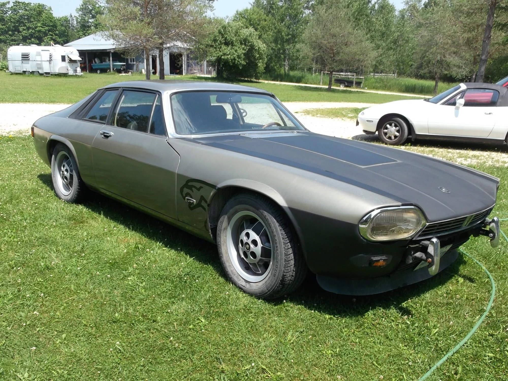

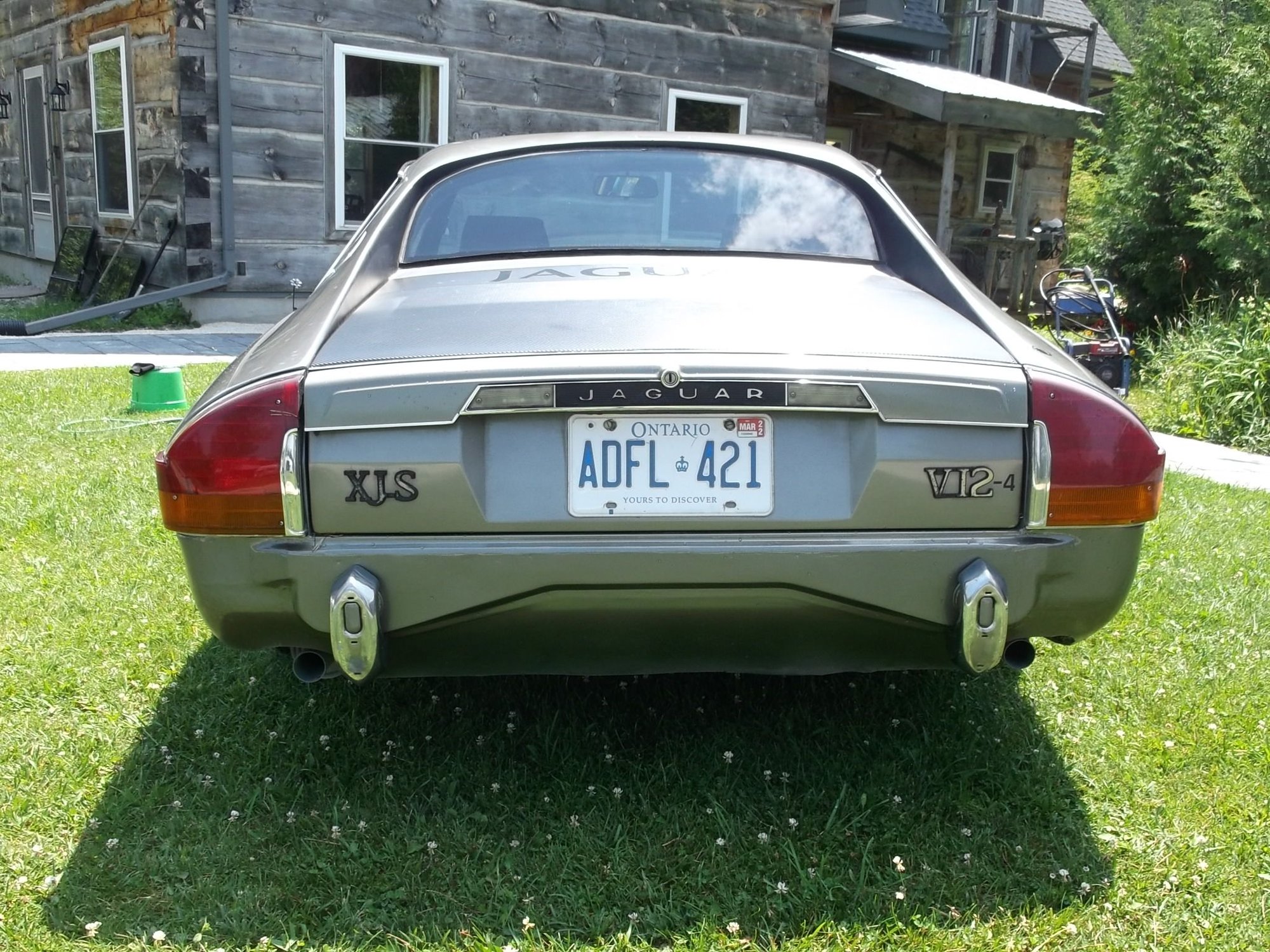

Profile updated...my XJS V12 is quite "altered", see attached photos. I tried to make it look as if it was 1973, pre big bumpers!

Can I just say that that is about the most beautiful XJS I've ever seen? This is very close to the look I'm going for with my own car, except I am keeping the chrome blades and deleting the tubes for the bumper shocks.
