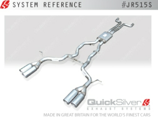

Brian id simply get a local exhaust shop to add a X pipe to your mid pipe not a hard job at all , tune with our guys on the forum and off you go it's literally day and night with the performance increase
Was Just thinking even easier would be for them to simply retain your rear muffler and add a h pipe just like the quicksilver mid pipe .
