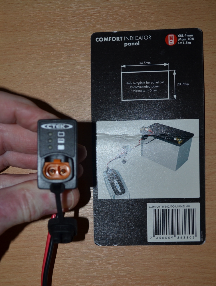

Looking at the Ctek comfort panel the socket is standard cigar socket so the Ctek MSX5 would need to be adapted to fit. But I am swaying the latter as I would only need to plug the Ctek charger in when required by the indicators.
Old Jan 1, 2018 | 06:44 AM
Likes: 17,009
The socket on my Comfort Indicator Panel is standard CTEK:
I've never needed to use a fast charger as the CTEK maintains the battery. Whichever car I'm using, the other is in the garage on CTEK.
