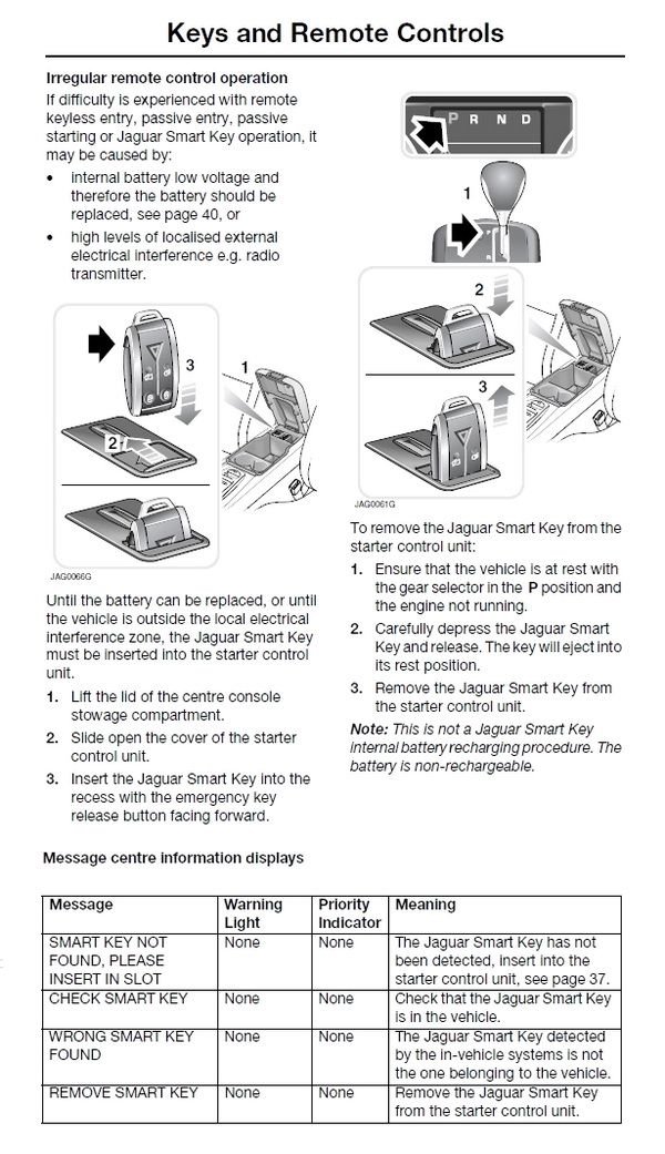

..... I also tested the smart key in its slot in the centre arm rest, and it did nothing; it wasn't sucked in ......
You just need to fully insert it. It doesn't injest the Smartkey .......

Graham, thanks for replying. But as I explained, the best fob does get drawn into the holder and then turns the igition on, but doesnt allow the starter to run.To get it out takes a little push down and then it pops up and out. This all feels normal, apart from not allowing the starter to run. But the tatty old one doesnt get drawn in.

Now some BAD NEWS. It sounds like you are inserting the Smartkey into the Starter Control Unit in exactly the correct method.
As neither are allowing the engine to start and you don't report any of the above messages, it's likely the Starter Control Unit is faulty. I can recall seeing a report of this on the forum so it's rare but not unknown.
Throwing parts at a Jaguar is never a good plan The best approach would be a diagnostic check with SDD before spending on a new or used unit but this may not be available to you.

Your X150 has 2 security systems i) a passive system that wirelessly communicates with the vehicle and ii) an active system that relies on the physical presence of the key in the start control unit SCU aka the slot. It is likely that the key which does not stay in the scu was programmed by a locksmith and will operate wirelessly but is not authenticated to the car.
I suggest you review the attached for a full explanation

Described on pp 3034+ in the workshop manual. Sections marked as Anti-theft Active and, Anti-theft Passive.
