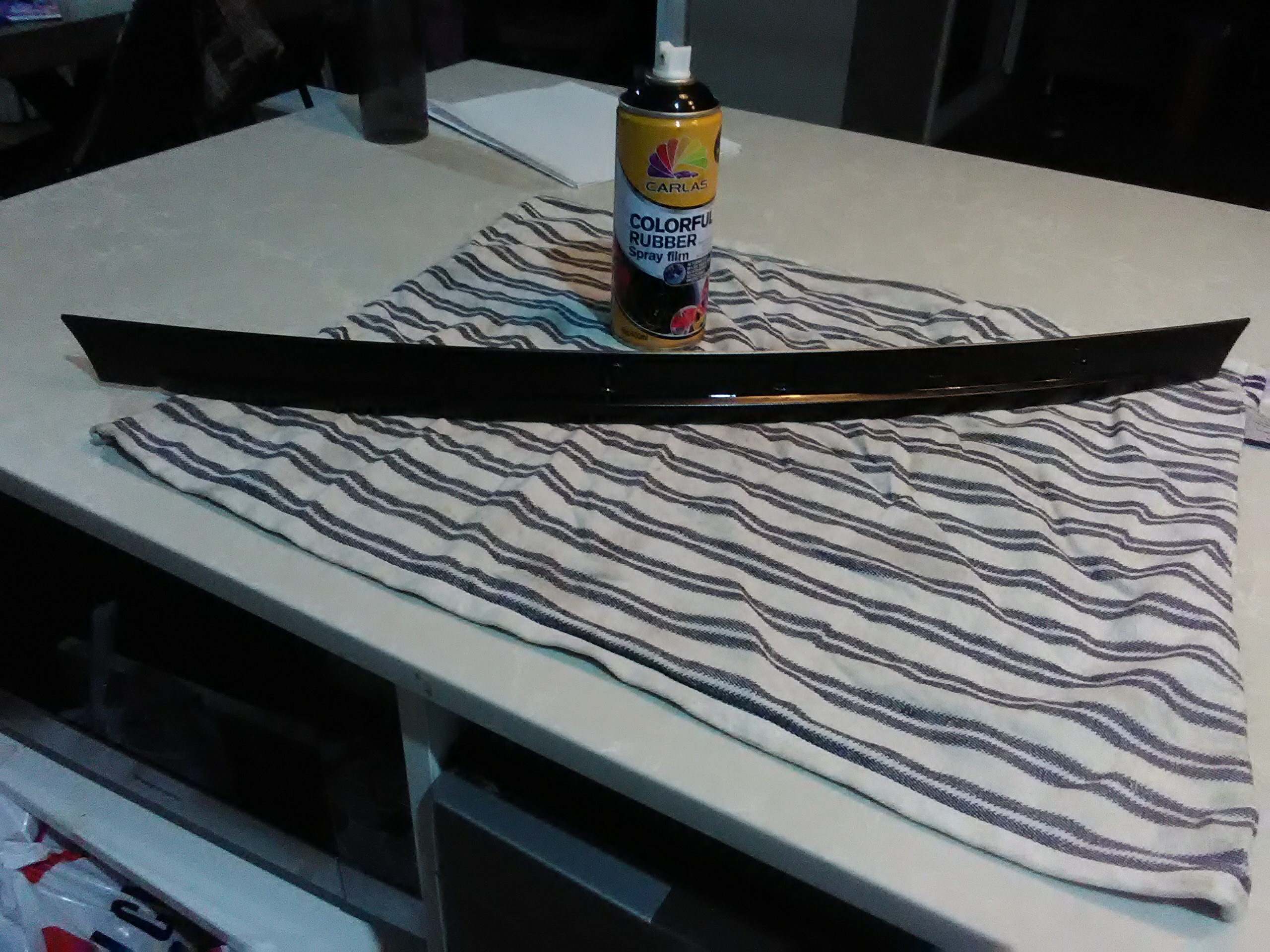

10 coats later and I'm almost there!
Attached Thumbnails What did you do to your X150 today?-1538817779399.jpg   What did you do to your X150 today?-1538817886603.jpg

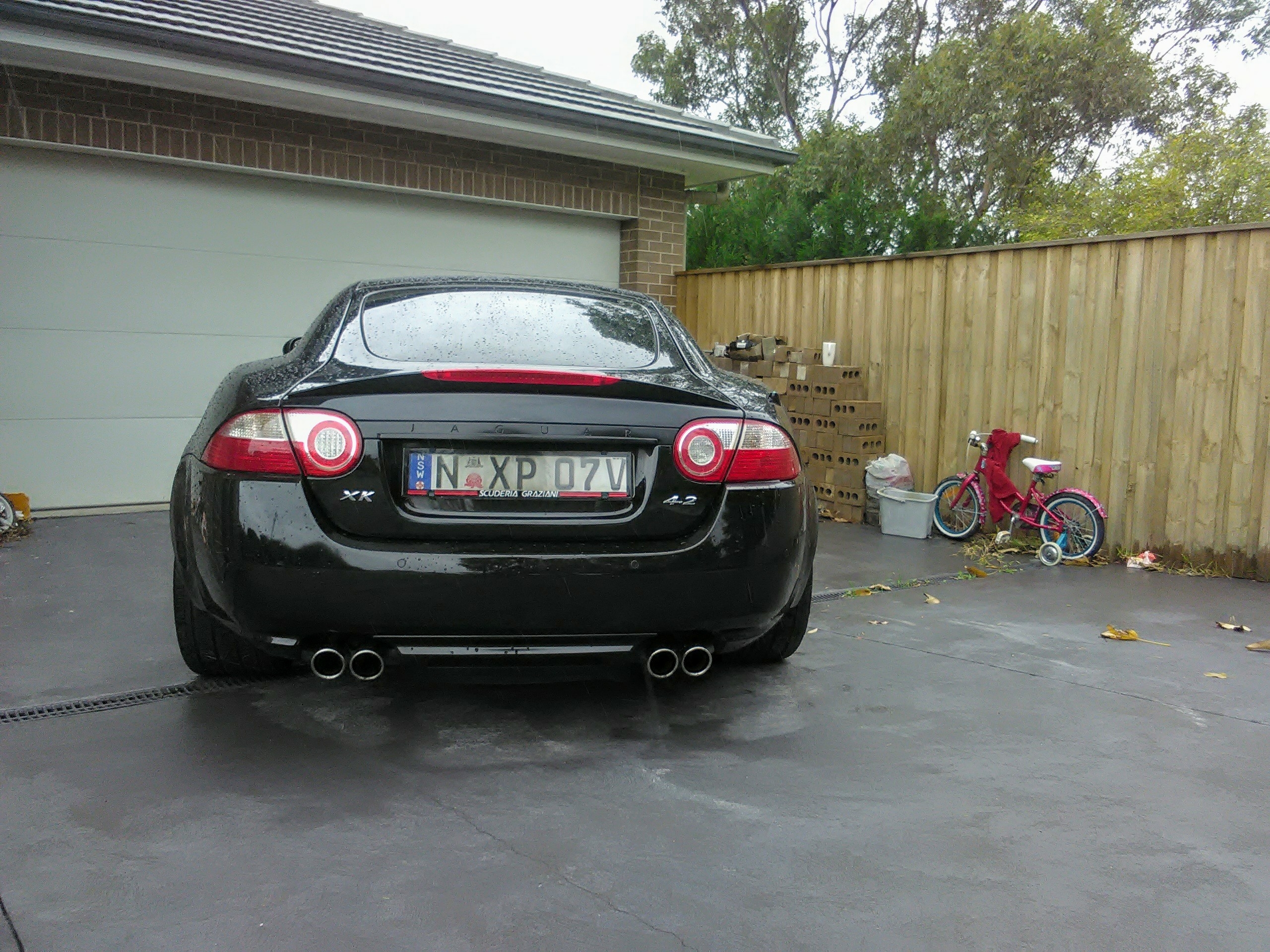

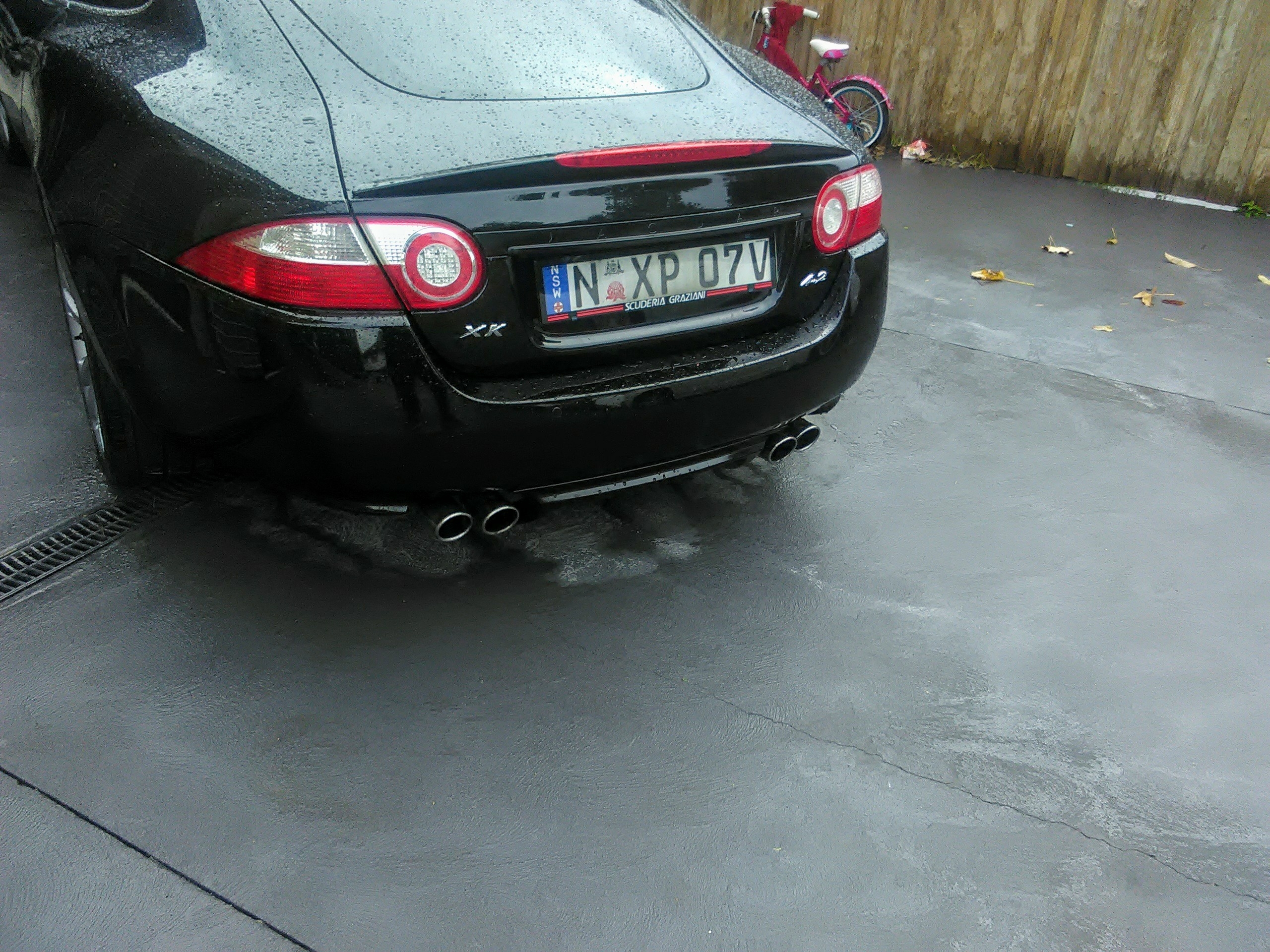

Much much better !!!
Chrome Blade gone I find the rear lights look much nicer now it was one of the gripes I was having with the non L.E.D lights.
Thoughts on de-badging ?? think it would look cleaner
Good job! Just black out the badging, or remove. Anything but the chrome would look good, I think.
That does look good!
I always thought the chrome strip blended well with the non-LED taillights, a nice bright stripe all the way across the rear end. But what you’ve done looks good too.
Since I went with the LEDs, I’ve thought that ‘broken’ line across my rear looks a little odd, so I’ll have to consider doing something like that.
I de-badged mine, no regrets... much cleaner look imo...
Sold on the idea I don't mind the window surround in chrome but them badges sick out like you know what
