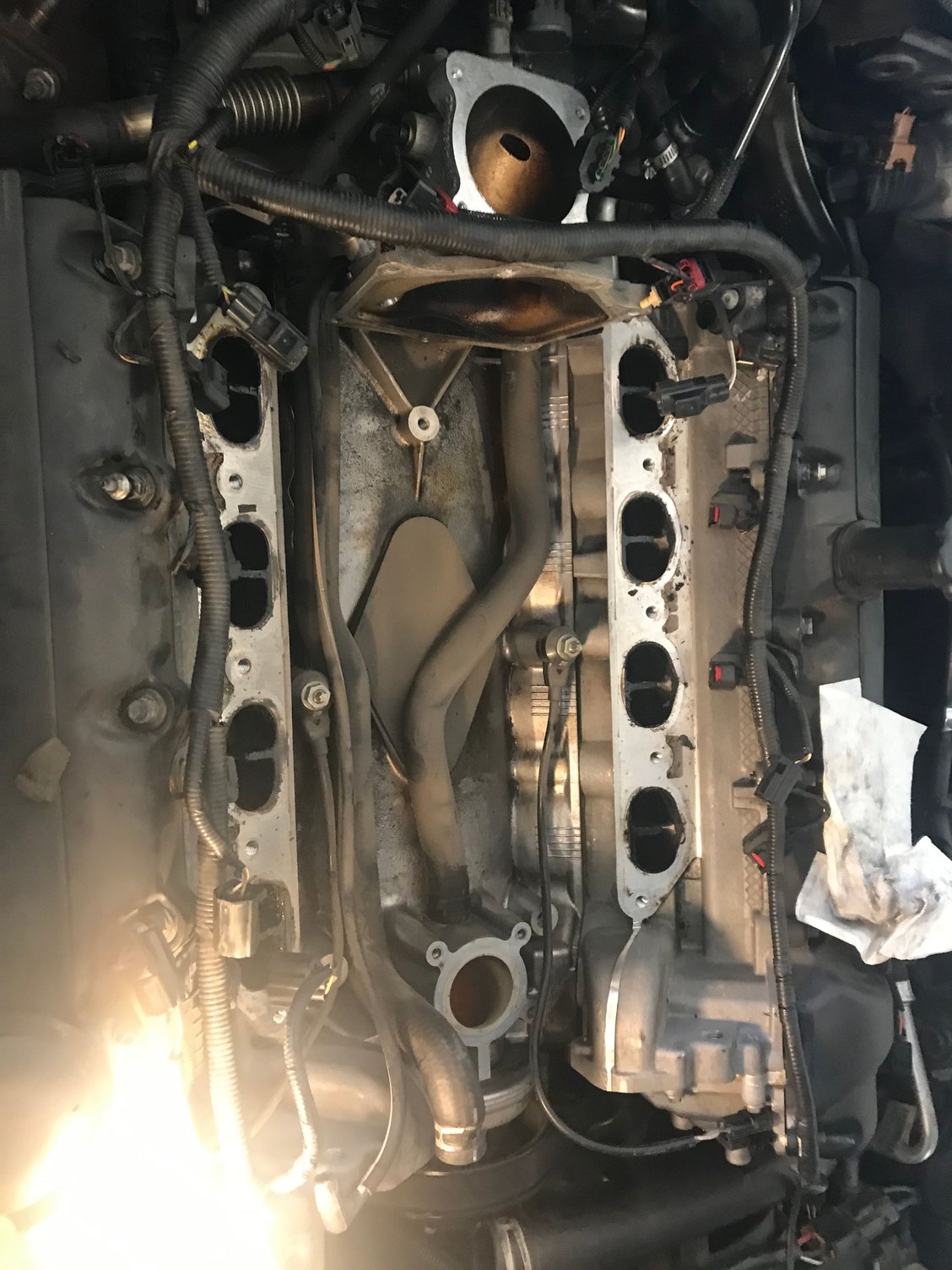

Anyways as you can see the intake is OFF!!!....fought me all the way with two clips holding a vacuum line under the intake.
Have I said that this is the most difficult engine I have ever, EVER....worked on!!!
Have the valley hoses on their way along with another plastic thermostat tower (outlet pipe), and intake gaskets.
