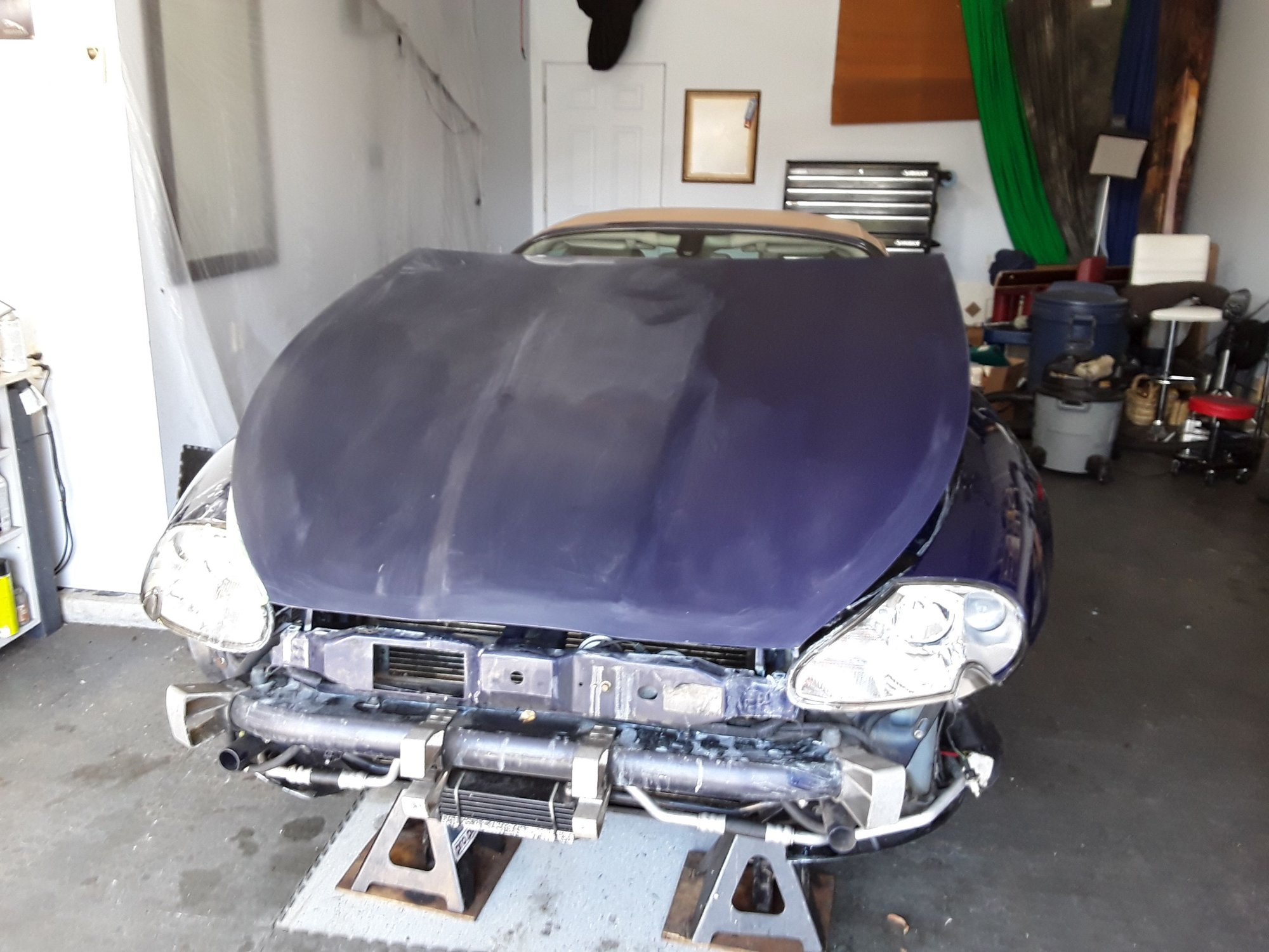

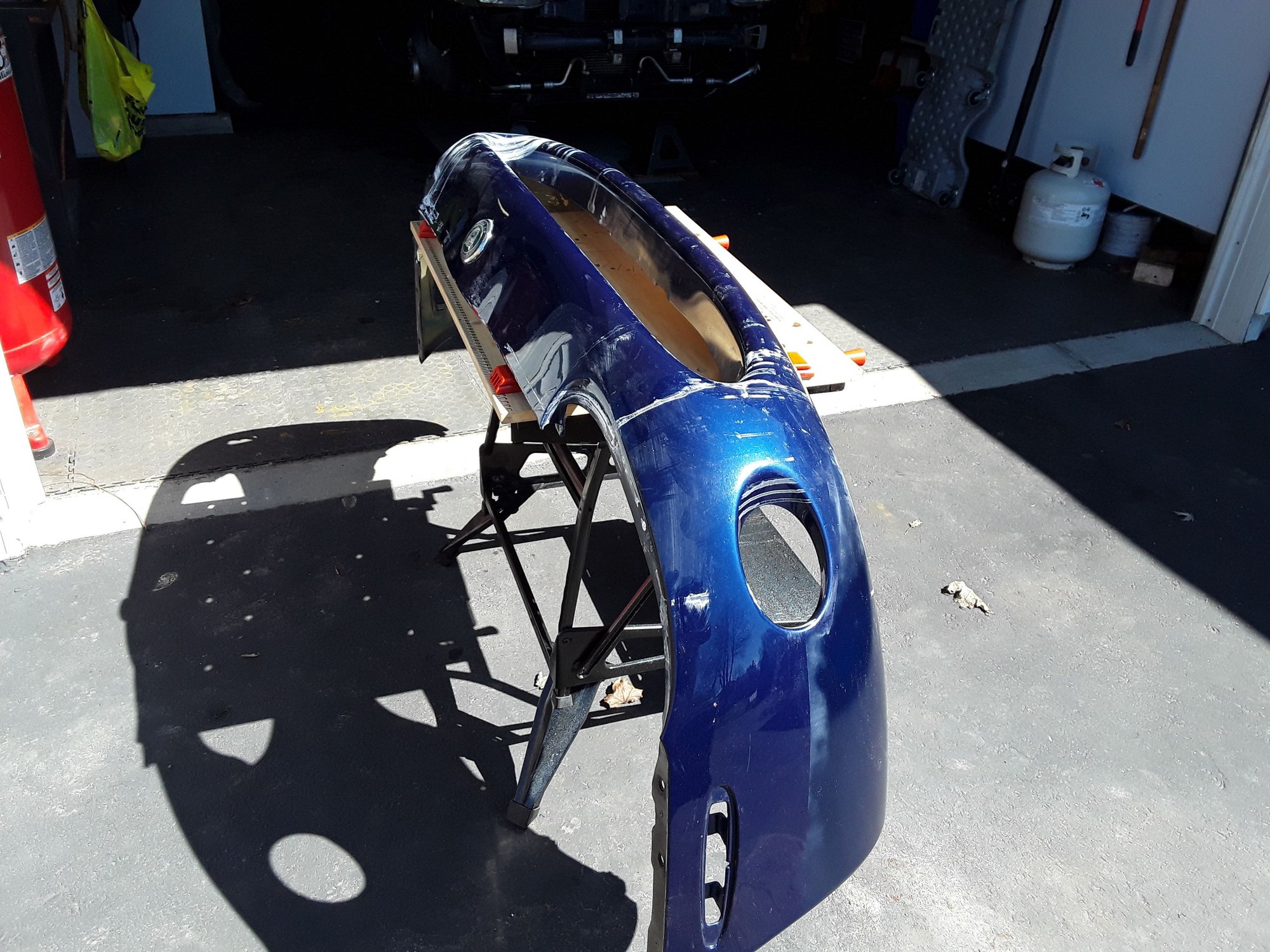

I just removed my bumper cover 2 days ago. It took about an hour once the car was jacked and had the front wheels off. It was a good opportunity the clean the crap out of the A/C condenser and clean all the road grunge off of everything. Peel back the inner fender liners and undo 3 bolts you can see above the side markers. 6 bolts you can see across the top of the rad with the hood up. Then undo all the screws across the bottom of the air dam.
I am repainting mine.
