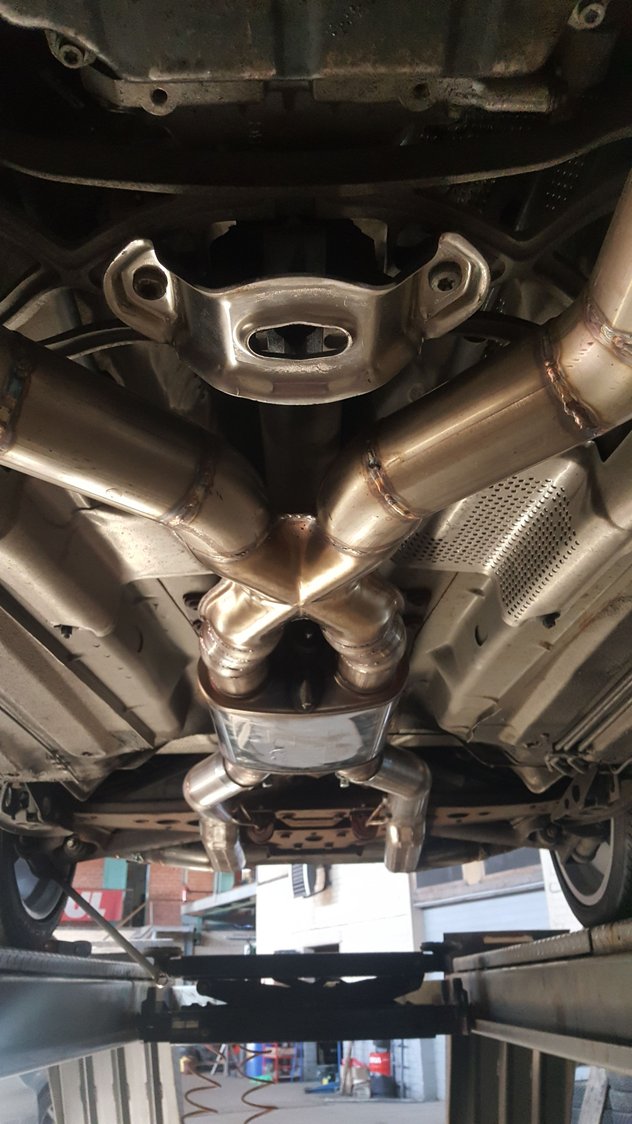

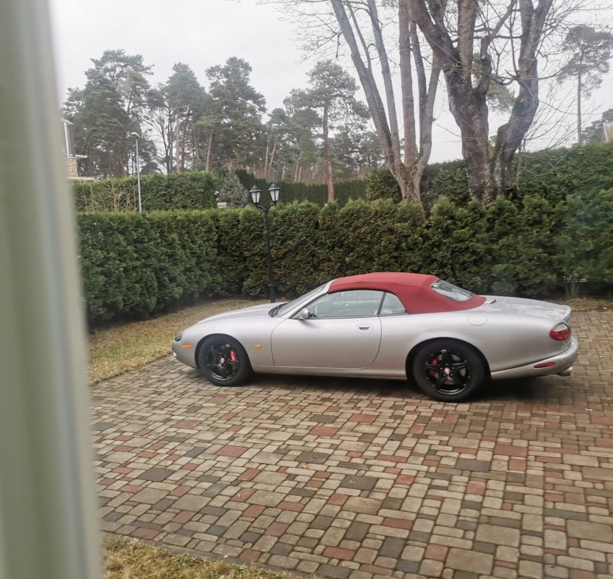

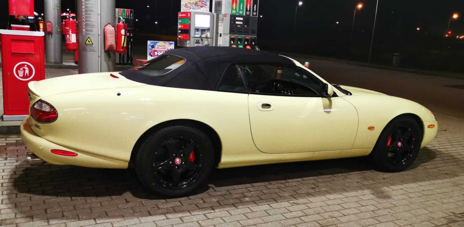

Hi. I understand that this topic is many years old but perhaps it may inspire or help others.
Yes, I fully agree that X100 are raised way too high from design point of view as well as the suspension is too soft for high speeds or sharp handling .
I replaced it with the coilovers at both cars and tried various drop levels - even when end of tyres were based on the fender level. It doesn't touch the ground at all, even having under axle exhaust system. The best coilovers for X100 I think are distributed via Swallows Racing in the UK, price is below 2K. Another 800 may be required for the full set of polyurethane bushes by PowerFlex. It available in colours or Black Series which are stiffer. Coilovers have 32 settings from soft to hard. The best front rear ratio in my opinion is when front rubber tyre is at the fender level, and rear one has a gap of +/-10mm. When you inside the car rear drops a bit, plus when accelerate rear goes even lower, that's why I prefer to set it up a bit higher than the front. Being lowered, handling is something else. If you add spacers 15-20-25mm wide, it becomes even much sharper. After all, the car looks COMPLETELY different. And another point, speaking about exhaust system. Maserati Quattroporte exhaust system in 2003-2006 was built by the musician, having one of the best sounds ever - from bass to howl, including mid diapason. I have tried (but not fitted) it on both XK8 and XKR, and it sounds far beyond of any expectations. Spare wheel compartment must be cut and modified for these boxes to be installed, but it 100% worth it - so amazing becomes the sound. My cars have 200cpsi cats, and X-pipe, and small resonators in between. Adding these two boxes would change the car presence and the whole driving experience. Maserati QP had similar 4.2 V8 (comparing to 4.0/4.2 AJ-V8), and a bit higher rpms (9K comparing to 7.5K). The tricky part is to fit quad exhaust which perfectly fits 2005/06 restyling rear bumper (2x50mm or 2x60mm pipes for each side), and that's it.
If I'll do it I will share the experience and its video, if someone is ready to follow that idea I can help with the details from my personal experience. I have tried almost all possible exhaust setups for both cars and must say that this setup will be the best possible for x100.
All the best,
Vadim
p.s. both cars currently are on sale via mobile.de and my plan/wish is to build another one from the scratch, but coupe. Something similar to those two cars are hard to find on the market, keeping in mind that fact that I'm selling it for less, and each car has more than 30Ks invested.

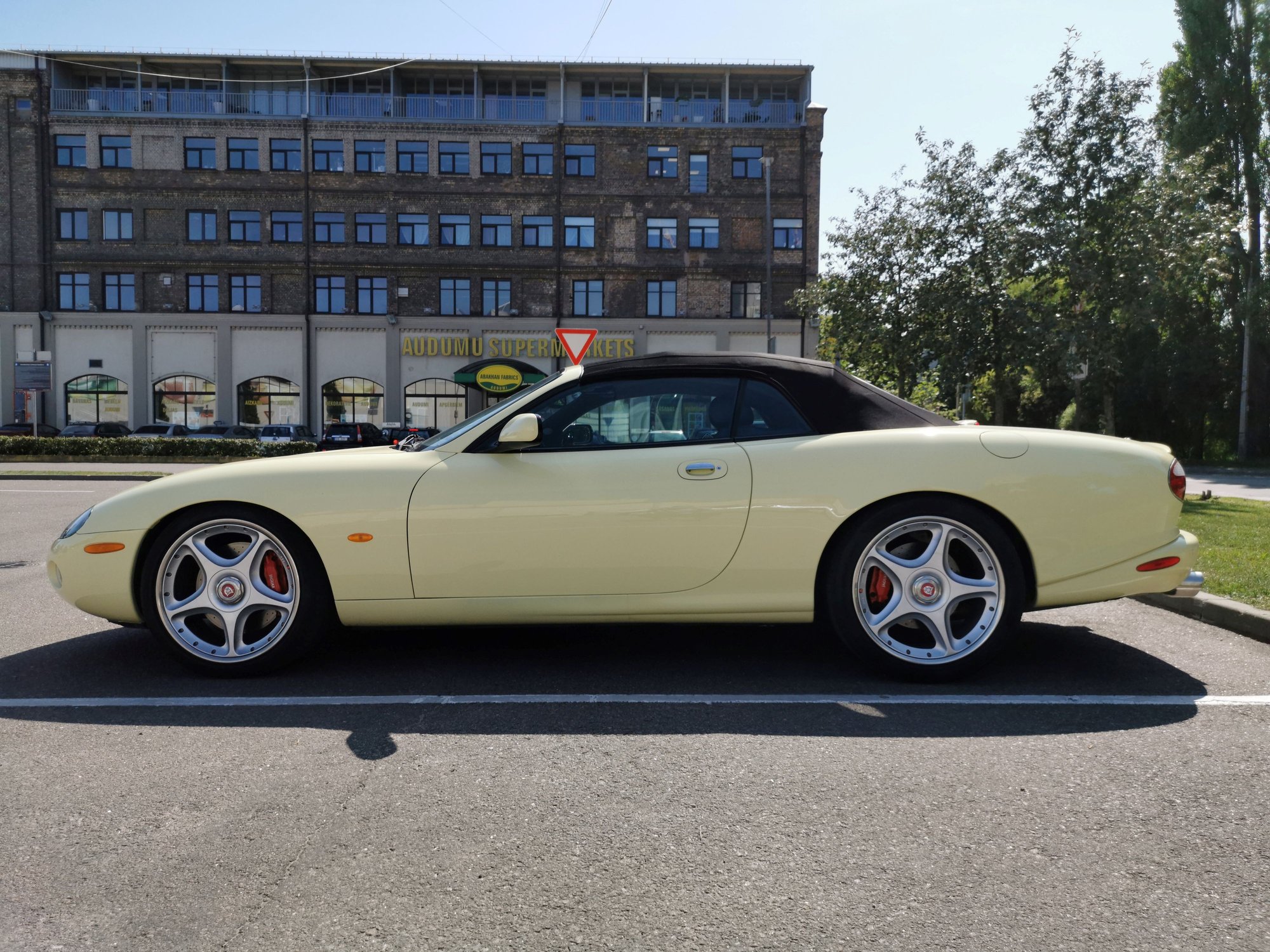

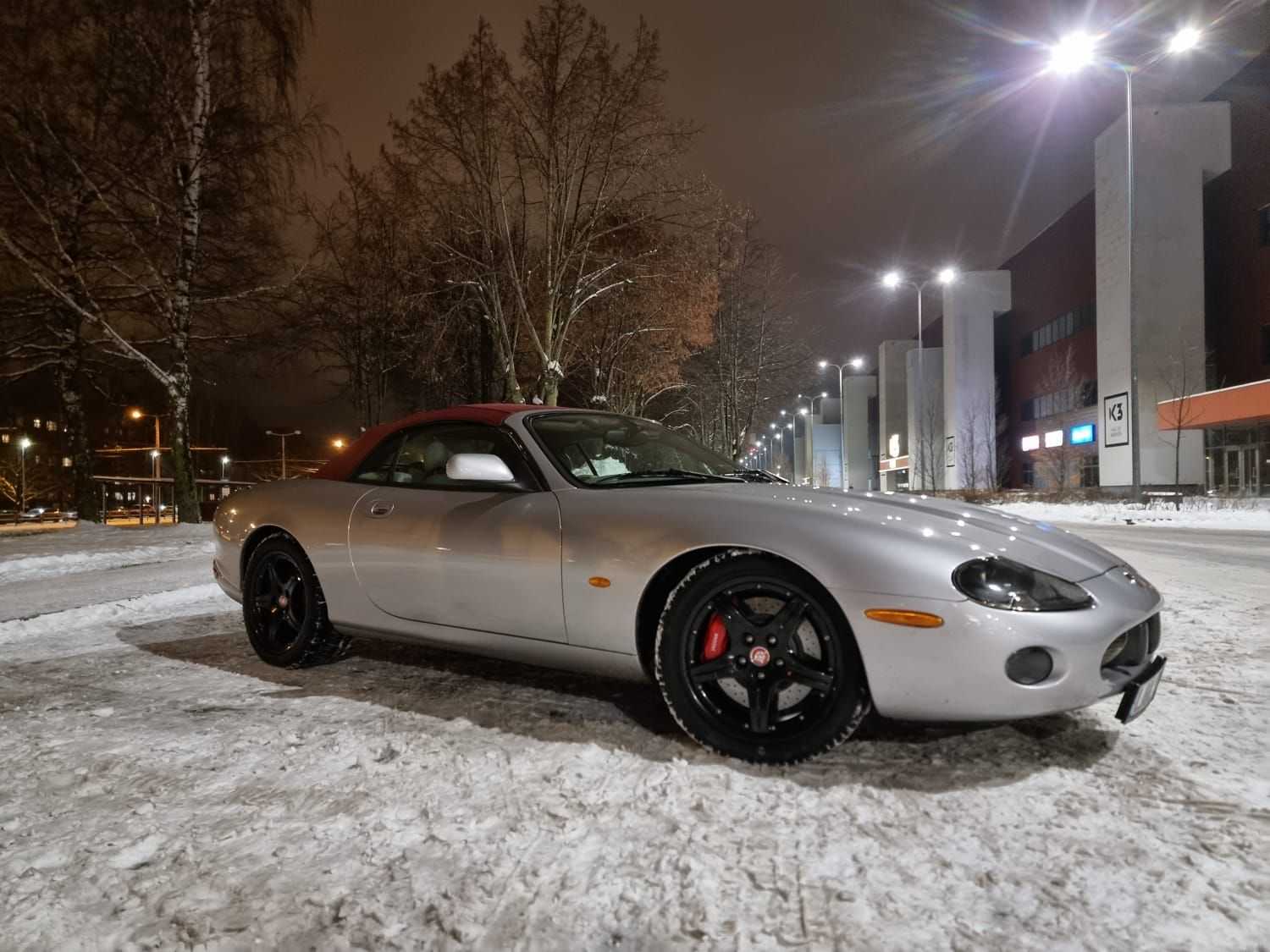

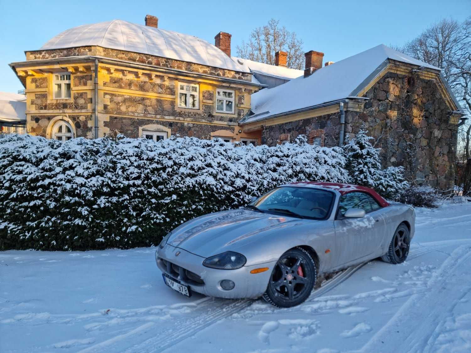

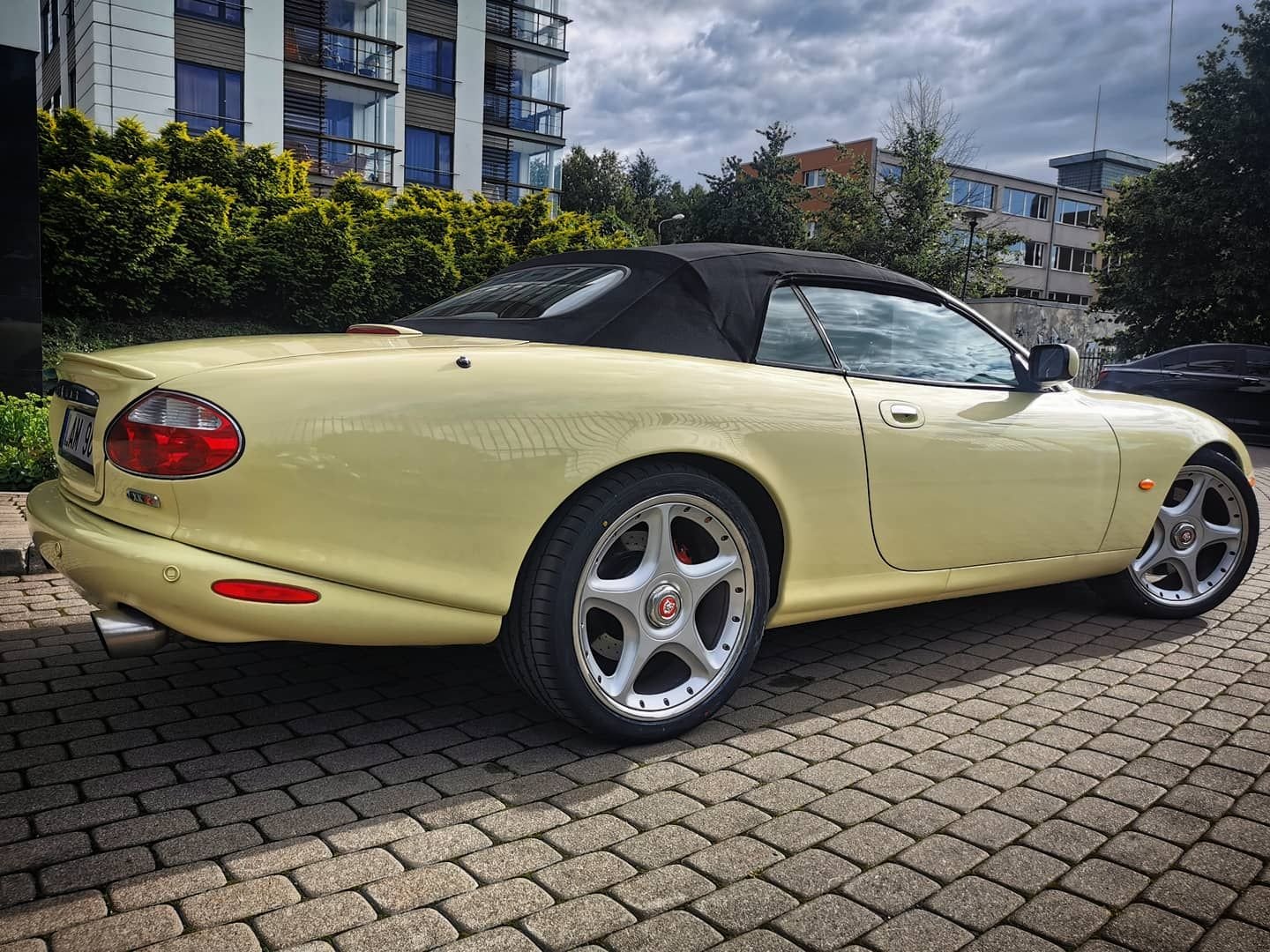

Here are some picture to see how lowered cars looks like.
