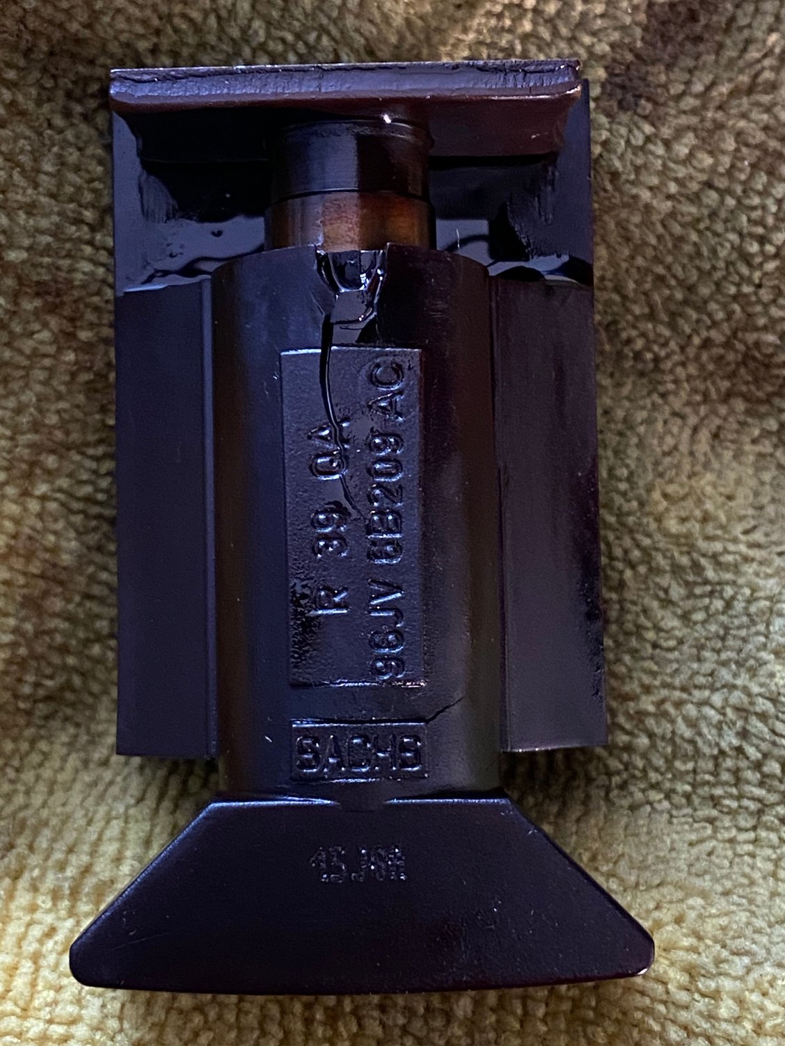

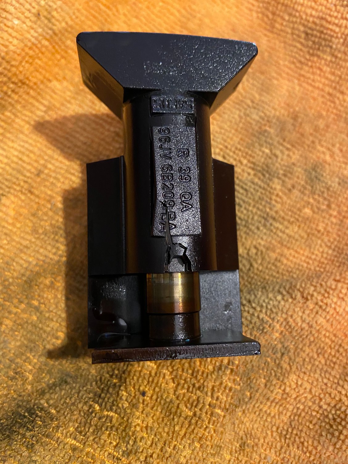

Pulled the cam cover to check the tensioners, is this one missing the bottom pad?
Is this one missing the pad?
Is that a body crack along the backing plate?

Bullet dodged. There's not a lot holding that piston in place:- you've definitely had your money's worth...
Yes, the plastic shoe is missing so running metal to metal.

Bet if you took the oil dump off you’ll find the broken plastic pieces.

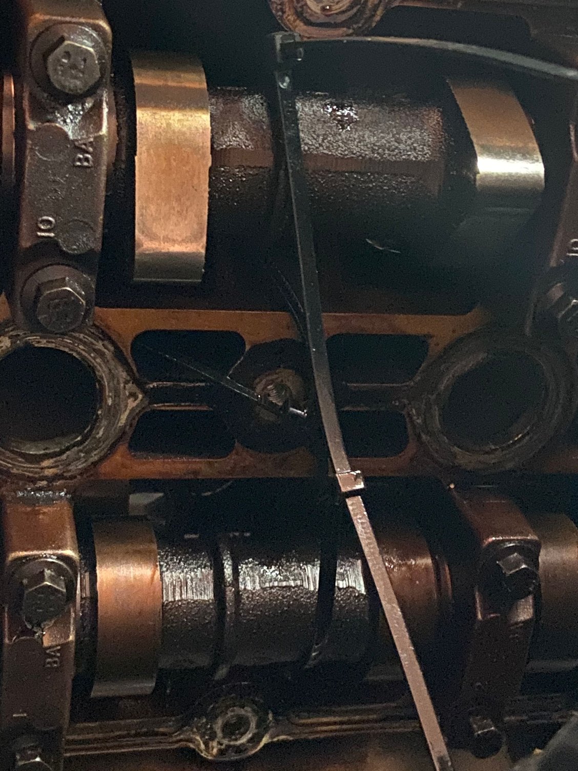

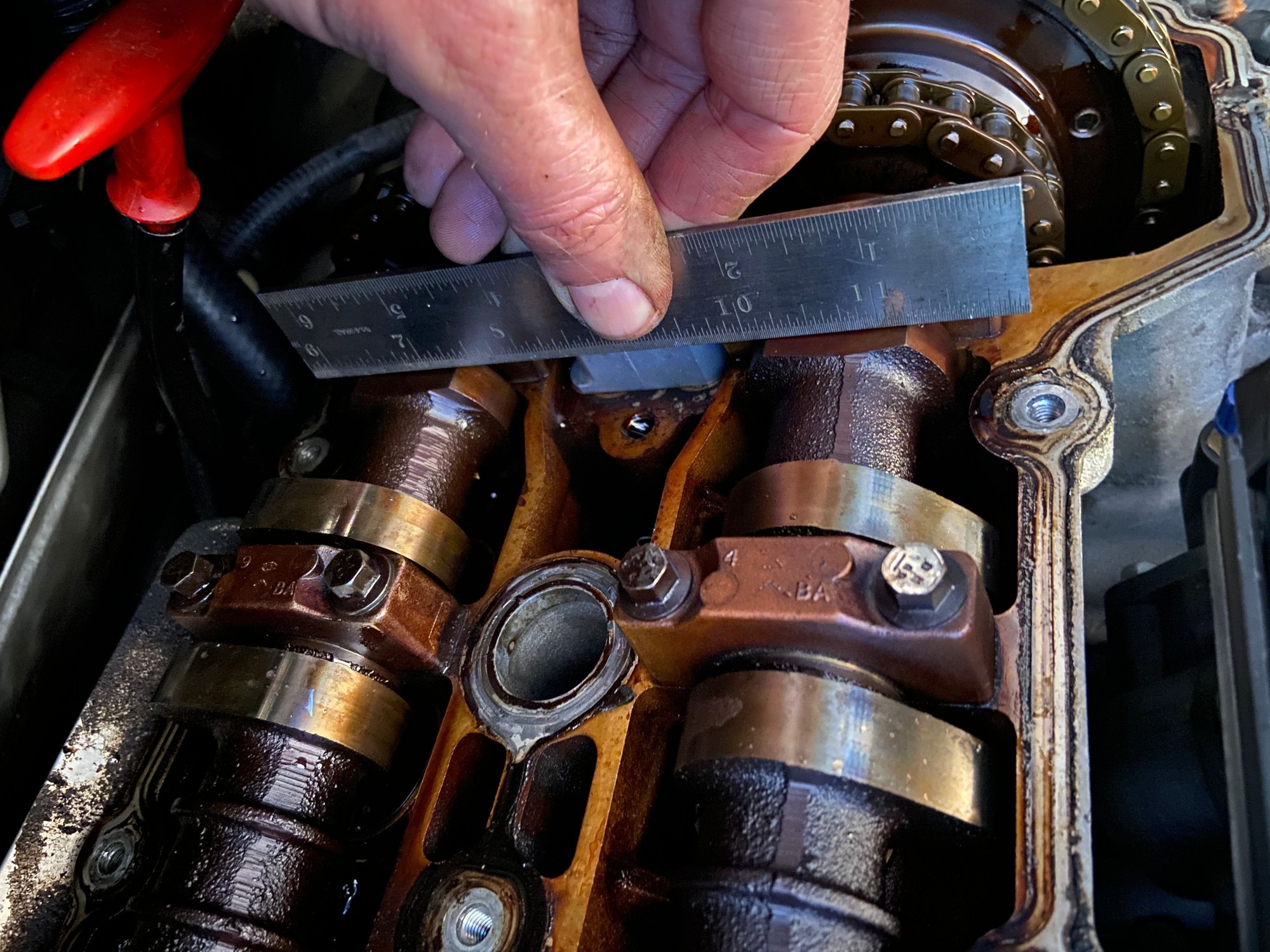

So, after scrounging around I ended up ordering two upper tensioners and cam cover gaskets from Moss, they seemed to have non Chinese made tensioners, which I’d seen all over eBay, and they’re no longer listed with the Ford dealerships up here. I did the ‘zip tie’ method after double checking that the timing was still correct. Notes:
mid you’re going to do the zip tie method, you should have a basic working knowledge of engine work, ie:

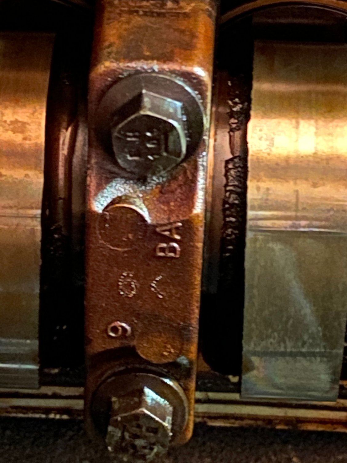

how not to bind the camshaft thrust surface while lifting and reseating. Go SLoW and move back and forth down the camshaft as you are reseating the caps, you are actually depressing a couple valves depending on where the cam is, it’s completely doable if you are cautious. The bearing caps on a 97 are etched with the position number and direction,
don’t screw this up, and lube the bearings going back together. You will need shorter bolts for the new tensioners, I got mine at ace hardware, if you look closely they are marked 10.9, go get the same thread, metric shoulder m6 x 30 10.9 bolt. It’ll be a 10mm head, but there are some identical ones at some stores (8mm) head.
anyway, zip tie loosely a big loop around the intake cam and exhaust cam at the other non chain end, so that when you pop the exhaust cam up you don’t flung the end down and scratch a bearing surface or something.

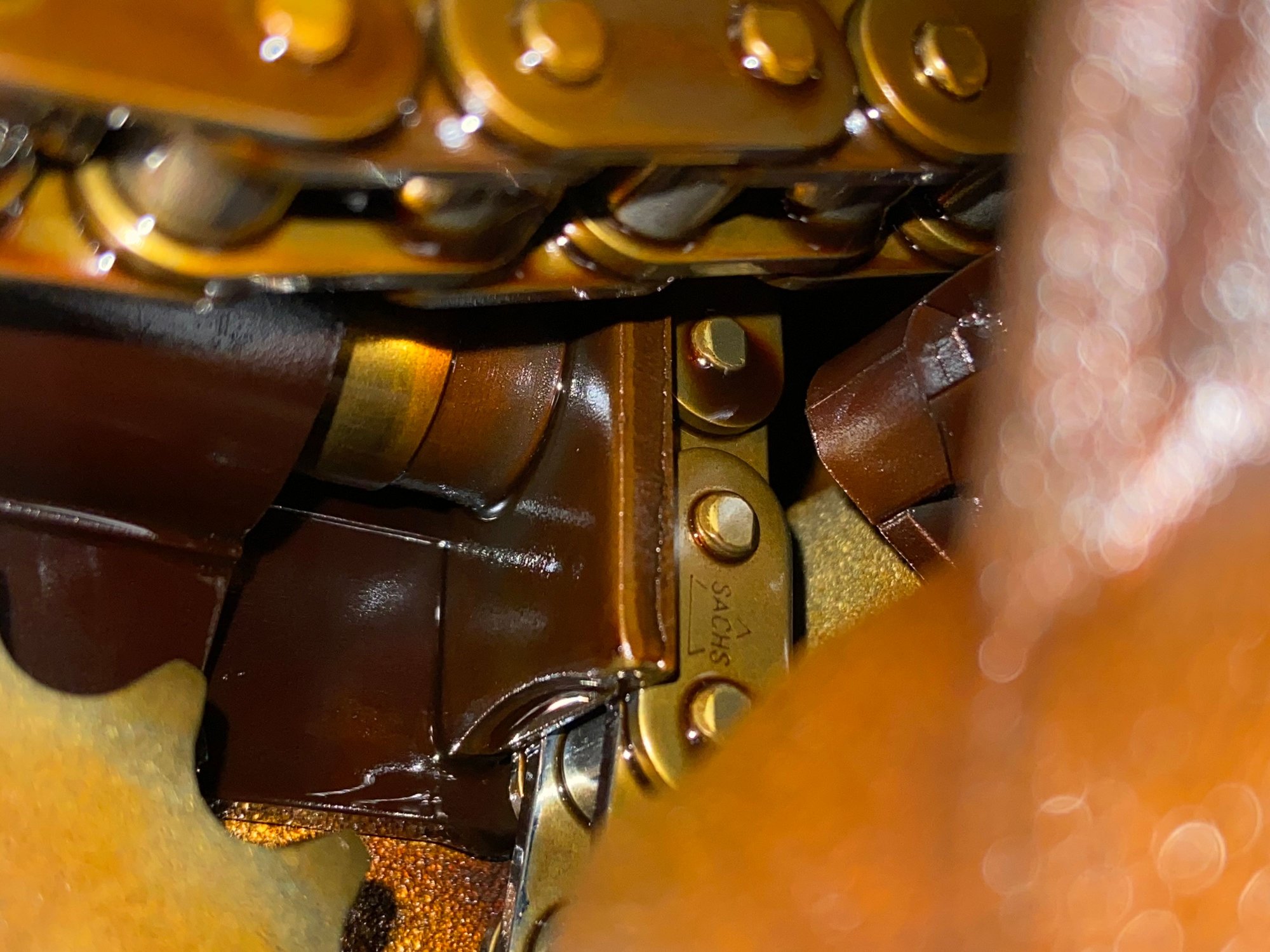

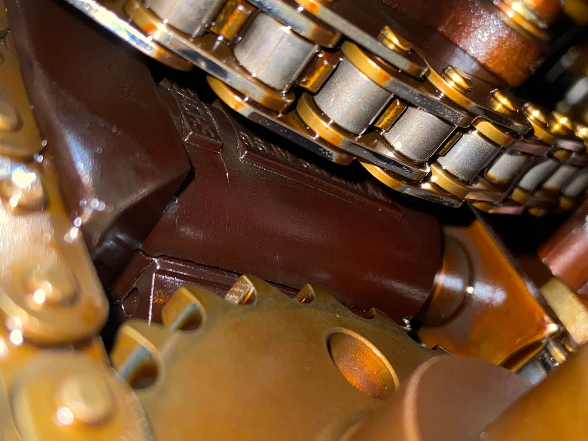

Anyway, so here were my tensioners,
there’s a metal sleeve inside the plastic housing, so the crack isn’t going to cause you to loose pressure, but the lost pad is certainly going to allow slop, I had a weird rattle, that was probably in the valve train until pressure built up. Either way it’s done now, fixed the spark plug well leaks, so a very good day.

Good job! You were so close to having a new coffee table! The new ones are the metal-bodied tensioners, right?
