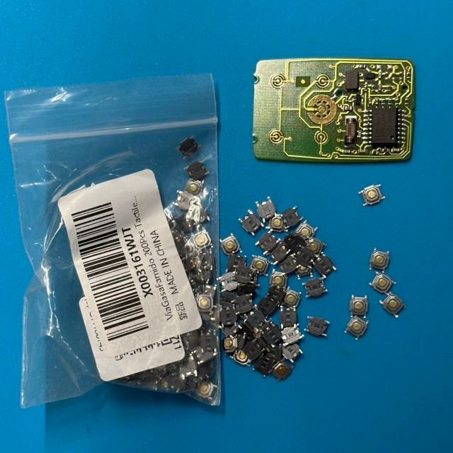

I decided I'd had enough of fob buttons not working properly. I've tried cleaning up the contacts (many times), and have used a "bake in the oven" conductive coating to re-coat the underside of the membrane buttons, but that also wears off after a while, causing other problems. So - here's what I did...
I searched amazon for "Tactile Push Button Switch" and looked through the results until I found some momentary push-buttons that were 4mm x 4mm x 1.5mm, which I figured would fit. (
These are the ones I used These are the ones I used
, although amazon links don't seem to work for long...)
If you look closely at each "touch pad" on the board, it comprises concentric circles that, when bridged, complete the circuit between two tracks. So - instead of completing the circuit by pressing a carbon-coated membrane onto it, I simply soldered a switch across those 2 tracks...

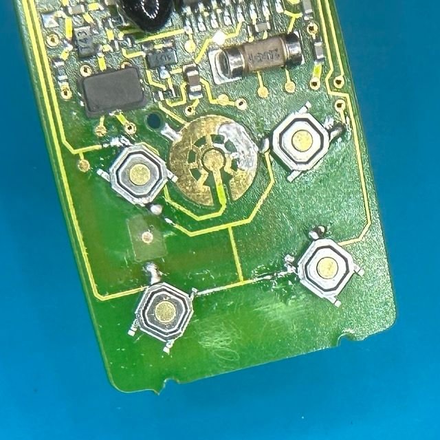

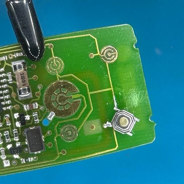

  1. For each of the 4 pads, I figured out exactly where I would solder the switch contacts to the tracks. With careful orientation, I was able to find positions for all 4 that ensured the button was centered on the pad, and the contacts aligned well, without needing to bridge any gaps.
  2. Then for each location, I removed the insulating coating from the tracks where I was planning to solder. I used a small piece of fine sandpaper (clumsily; you can see the scratches on the board).
  3. Next, I used a blob of superglue to hold the switch in place, and then soldered the contacts to the tracks:
I repeated this for each of the 4 pads, and here's the final result (just before I snipped off the unused contacts from the switches):
Now, my fob makes a super-satisfying "snap" sound when I push the buttons, and it always works - no more multiple presses or holding the remote against my head
I'm delighted with the results, and hope it helps or inspires anyone else who's thinking of giving it a go.
