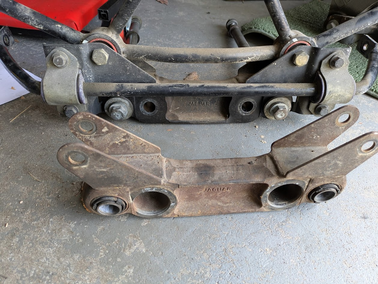

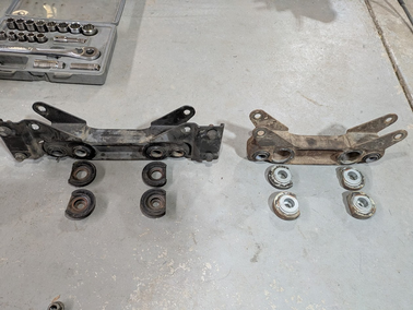

  • 1) for the wide mounting bracket, the 15HU pinion is offset, whereas the 14HU is centered
    • the X300 bracket must be used
    • the exhaust hanger brackets are at a different offset, with the 14HU brackets being closer to the center line.
    • Offset pinion X300 bracket below, and centered 14HU bracket above. Perspective is a bit deceptive in this image (lower bracket seems larger, but is not), but you can see that the bracket designs are different, and the center hole for the pinion is offset on the lower bracket compared to the upper. Also, the different exhaust hanger bracket locations (position and mounting angle), can be seen. The X300 exhaust hangers can be unbolted and remounted in the correct position and angle (weld, rivet, bolt, etc.) with a bit of creativity.

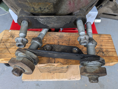

  • 2) the wishbone tie, wishbone mounting bracket, and suspension mounting studs
    • Baxtor’s approach was to use the 14HU wishbone tie and wishbone mounting bracket, and turn down the 15HU mounting studs to fit, and then add spacers at the rear due to the longer protruding thread
    • An alternative is to use the X300 wishbone tie from an XJR/XJ Sport (note Vanden Plas etc. wishbone ties do not have the anti-roll bar mounts for the bushings, so can’t be used unless new brackets are added), the X300 wishbone mounting bracket (although the 14HU versions could presumably be drilled to the larger diameter), and the X300 mounting studs
    • As Baxtor noted, the mounting studs for the X300 are longer, engage deeper in the differential housing, and have a larger diameter into the wishbone tie. Below you can see that 14HU differential with attached mounting bracket and studs above, with 15HU bracket (Vanden Plas) and studs in front/below.
  • The X300 XJR and non-XJR seem to use slightly different wishbone designs. The image shows a Vanden Plas 15HU wishbone tie in front (with no anti-roll bar brackets), and the 14HU wishbone tie at the back.

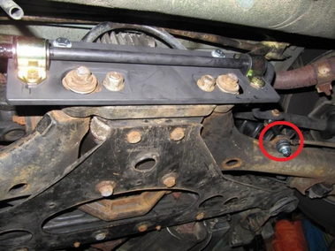

  • One workaround is to add an anti-roll bar to an X300 wishbone tie, as shown here (ignore the red circle)
  • An X300 XJR assembly with a wishbone tie that does have the anti-roll bar brackets is shown below
  • The XJR wishbone tie stud washers have rubber gaskets, whereas the non-XJR use larger holes in the wishbone tie with ‘pilot’ washers.

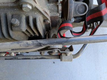

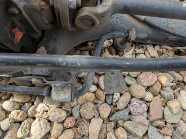

  • 3) The anti roll bar thickness is different (~15mm for X300 and ~17 mm for XKR non-R version), and the links are of a different design.(although mounting brackets are similar)
    • X100 anti-roll bar, bushings, and links should be used (unless a different rated roll bar is desired…)
    • The X100 anti-roll bar is shown below (poor picture, but you can see the drop link between the folds of the safety strap on the right)
  • Below, the X300 anti-roll bar (when fitted…)

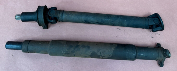

  • 4) Driveshaft flange at pinion end
    • The X100 XKR/Mercedes driveshaft has a 4 bolt flange (circular pattern) at the pinion end, and a 3+3 bolt jurid coupling at the transmission output, with a two piece driveshaft in between including a center bearing aft of the slip joint.
      • Bolt circle diameter for the pinion flange appears to be about 3 1/8 inch or 79mm (TBC)
      • Pilot diameter appears to be about 2.375 inch
  • The X300 has a 3+3 bolt jurid coupling at the 10 spline pinion.
  • However, the 15HU pinion extended shaft for the Jurid centering cut be cut down, and the jurid mounting flange replaced with a suitable 10 spline Jaguar flange (per Baxtor – XJS 10 spline flange? ). I don’t have much information on the various Jaguar pinion flange bolt patterns
  • Note that Baxtor needed to add a spacer between the flanges
  • If using a Dana44 26 spline pinion then there is a larger challenge since the driveshaft flange is a 1300 series UJ, and 26 spline flanges are typically 1310 series. A 26 spline pinion yoke with ‘traditional’ Jaguar bolt pattern ( rectangle 2.0 x 2.375 ) is Spicer 2-1-1881X, and this will mate with a 1310 flange such as 2-2-329 (Male pilot 2.375 diameter, center of u-joint bore to Face of flange is smaller than 2-2-459) or 2-2-459 (Male pilot 2.375 diameter, Center of u-joint bore to Face of flange = 1.625 inches ). This still leaves the issue of connecting the 1310 flange to the 1300 driveshaft UJ. Options include a custom driveshaft, or maybe at a pinch using a 1310 UJ, and tack welding plus welding washers over the ends on the driveshaft 1300 yoke, since a 1310 will fit about flush when centered.
  • Another alternative is to do something really fancy like post #168 of this thread, and get custom made 30 spline output shafts and 26 spline input flange for Jurid coupling, budget permitting….
  • If using a JK pinion, then the requirements change again since it uses a 24 spline input flange, and typically this would use a 1350 series UJ. One option is to use Spicer 2006269/268 pinion companion flange, and Spicer 3-2-1879 yoke flange, although these are quite large, but it proved time consuming to find a matching pair and these do seem to work (4.25 in bolt circle, 4 x 1/2” holes, 2.6 in pilot). The challenge of connecting the 1300 series driveshaft to the 1350 yoke is then as above. One option is again to use a custom made rear driveshaft section with 1300 and 1350 fittings at the front and back respectively, and in this case it should be shortened by about 0.2 inches (center to center of UJs). This is the solution I used.
  • Note that when connecting the driveshaft to the pinion, if using a greaseable UJ, then ensure that the grease fitting is under compression (being squashed) by the driveshaft rotation transferring torque to the pinon, and not under tension (being stretched) to minimize the change of the UJ failing.

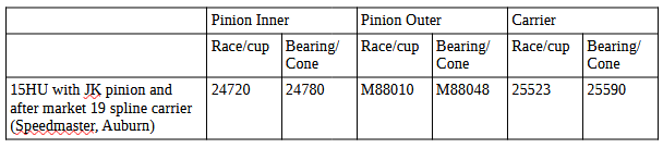

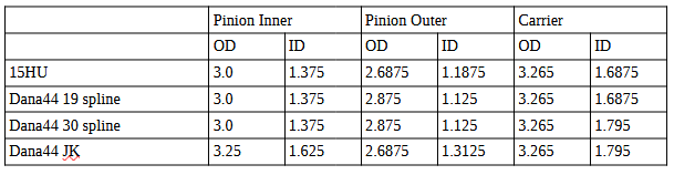

    • The GKN/Salisbury 15HU housing and the Dana44 housing are fairly similar, but not identical, noting that a genuine Dana44 rear was actually used on a few XJSs. There are also differences between the Dana44 19 spline and 30 spline output shaft variants. And on top of this, the ‘JK’ Dana44 is not the same as the ‘standard’ Dana44 (or the Super Dana44, or any of the other variants….), noting that a popular modification is to put a JK ring and gear into a standard Dana44 housing, also known as a ‘big pinion’ conversion.
    • One of the key differences is in the bearings, which is summarized below.
  • Obvious from above is that the JK pinion is much thicker and stronger, which when combined with the large 8.8 in ring gear results in a significantly stronger overall setup.
  • Another difference is that the after market limited slip carriers mostly conform to the 30 spline spec for carrier bearing ID (1.795), so they use the larger bearing diameter even when supplied as 19 spline, in contrast to the OEM Jaguar carrier.
  • I chose to use a Speedmaster Dana44 worm gear carrier with 19 spline outputs (PCE 204.1059) (similar in operation to a Quaife, etc.), mainly because it is predrilled for 3 different ring gear bolt sizes (3/8, 7/16, 1/2), which accommodated the ½ inch bolts that are used on the 3.73 JK ring gear I obtained. And the black friday deal was excellent. An alternative would be the Auburn Dana44 Grip-N-Loc 546085 if clutch style locking is preferred, but the bolt holes will have to be drilled out for a JK ring, as would the OEM Jaguar carrier. The difference in price between usual, and ‘on sale’ seems to be be massive (> 2X discount) in the aftermarket for these types of parts, so I you are not in a hurry I suggest waiting for your preferred carrier to go on sale. Both these carriers are for 3.73 and down carrier offset, so should work for ratios from stock Jaguar 3.07 up to 3.73, depending on what ratios can be found in the aftermarket.
  • I installed the carrier in a housing from an X300 Vanden Plas, and re-used the mounting brackets from it as well. The wishbone tie and associated hardware came from an X300 XJR.
  • Required bearings can be figured out fairly easily by looking at the bearings used on various known models using the different differentials (such as rock auto), and browsing a online bearing catalog (such as Timken) to cross reference using interior and exterior diameters, and bearing thicknesses. The bearings for JK ring and pinion when used with the Speedmaster carrier are:
  • Comparing Salisbury and Dana44 bearings
    • Inner pinion 89410/89446 versus 31520/31594. Dimensions are the same, width is the same at 1.1563, Salisbury bearings have a higher load rating
    • Outer pinion 88043/88010 versus 02820/02872. ID and OD dimensions are different, same width of 0.875
  • Then looking at the bearings required to install the JK pinion in the 15HU housing
    • Inner pinion 24720/24780 width is 0.875, which is 0.281 less than the 1.1563 OEM width
    • Outer pinion M88010/M88048 width is 0.875, which is the same as OEM
  • This means a thick spacer is required behind the inner pinion race to make up for the much thinner inner pinion bearing.
  • Various internet info ( unverified by me) suggests that both the Salisbury housing, and the Dana44 JK, have master housing dimension of 4.312 in (depth from carrier bearing center line to top of inner pinion bearing) and pinion depth of 2.625 in (depth from carrier bearing center line to top of pinion). This obviously would mean the larger JK ring gear is ~0.15 in closer to the top of the inner pinion bearing that the 15HU ring, so the bottom of the JK pinion is set lower than the 15HU pinion, if the pinion depths are the same for both.
  • If (again unverified) the 15HU is similar to the earlier 4HA housing, then the inner pinion bearing is at a depth of 5.5 in (+/- 0.005). The 15HU bearing thickness is 1.1563, which allows for approximately 0.0317 additional for shimming adjustments to the 4.213 master housing dimension.
  • Given the 0.281 in difference in bearing thickness between 15HU and JK, and the 0.0317 allowed for 15HU pinion depth adjustment, this implies total shim depth required to fit the JK inner pinion is 0.313, before accounting for depth adjustments.
  • Note also that carrier bearing 25523/25590 has a total width of 1.0625 in. The Jaguar OEM carrier bearing is 25523/25577, which has a total width of 1.00 in, so a difference of 0.0625 per bearing. The after market 19 spline carriers have an OD of 1.795 (same as Dana44 30 spline carrier), instead of the OEM Jaguar 19 spline at 1.6875, so they are slightly stronger

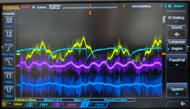

buried in my ramblings was this bullet point
  • As extensively discussed in other threads, you will also need a solution for the TCM to use a different ratio – either a TCM (EGS51) reprogram, or a Canbus spoofing box, or similar.
this alluded to the following link, and was also discussed in Baxtor's 15HU thread:
and the github link here
I don't know of anyone that has tried the canbus ABS wheel speed modification approach with the 5HP24 yet, although I would optimistically guess that it would probably work.
Certainly the Mercedes TCM (Siemens EGS51 for the XKR) is not tolerant of a ratio change, and needs intervention for a 3.06 to 3.27 ratio change (and obviously larger like 3.73), or will trigger a 'gearbox fault' on the instrument pack display and put the transmission into limp mode.
(I would assume the 'second gear skip through' technique to bypass the ratio checking is unique to the Mercedes, so likely not applicable to the ZF (Bosch?) TCM)
So whilst I am cheering you on with your project, I am guessing there is a significant chance you will run into similar issues with the TCM even with the 3.21 ratio, and need to either make an electronic solution like I did, or create a mechanical one like Baxtor suggests, or maybe there is someone that has a reprogram service for the ZF TCM.
On the mechanical side, at least with outfits like SendCutSend and similar, it is a lot cheaper to get laser cut custom projects than it used to be. I use FreeCAD for design, and have had great results in various projects with laser cutting and sheet metal bending.

The problem I see with changing the wheel speed sensor is that it's not the wheel speed sensor that is the issue. Secondly if you do change the wheel speed sensor but cutting a new impulse encoder by either increasing or decreasing those it's going to have an effect on your speedometer that won't read correctly.
So as I understand this there is a direct correlation between the transmission speed sensor and the wheel sensor and that this information is processed at the TCM or maybe the ECM which also receives this information. That information is then compared to what the actual reading is and what it thinks the actual reading should be and depending on what it detects it will either determine the information is correct or that the information is faulty due to a miscalculation or a number it doesn't recognize.
To me the issue really needs dealt with at the transmission speed sensor and this is where the can bus interceptor can pick up those pulse codes and then repeat them to the receiver such as the TCM. We are basically altering the actual pulse codes and then sending them a artificial pulse code that is modified by some can bus receiver/transmitter to match what the TCM or ECM expects to receive so that way it doesn't go into limp mode.
So as I have explained this and people can correct me if I am wrong here because I don't claim to be an expert here I am just explain it the way I understand it. A change in the wheel encoders won't really solve this problem. Now I have to say there could be a pulse encoder on the transmission that could be changed and maybe even fabricated but that would also require a possible rebuilding of the transmission and I don't even know if this is possible and I haven't read any threads to indicate this is what someone has done.
Getting back to a can bus interceptor device again we are altering the pulse codes. So if for example we know we have increased our gear ratio by say (example 15% from a 3.08 to a 3.54) then we program the interceptor to add 15% more pulse codes to whatever pulse it is sending from the Transmission speed sensor. Whatever the difference between the original 3.08 ratio is changed to must be calculated by a percentage and then have that percentage of pulses added to the output of the interceptor so that the TCM receives what it thinks it should receive. This is the electronic method for resolving this issue as I know it. The mechanical method or the changing of the encoders does not appear to be a viable option which is why I haven't really seen or heard anyone doing it.
