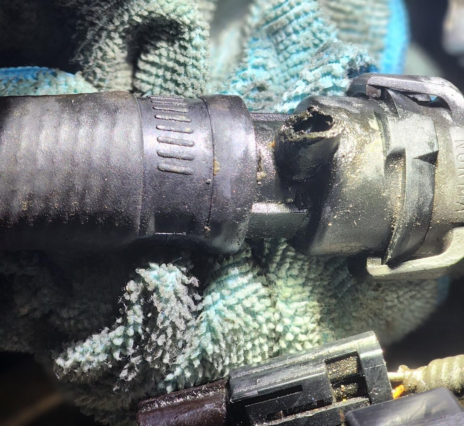

My '99 XK8 developed a leak at the juncture between the coolant tube emanating from under the intake manifold to the NORMA fitting on the Octopus Hose. Please see the photo. Does anyone have experience with this? Part number or work-around?
Many thanks for the collective insight.

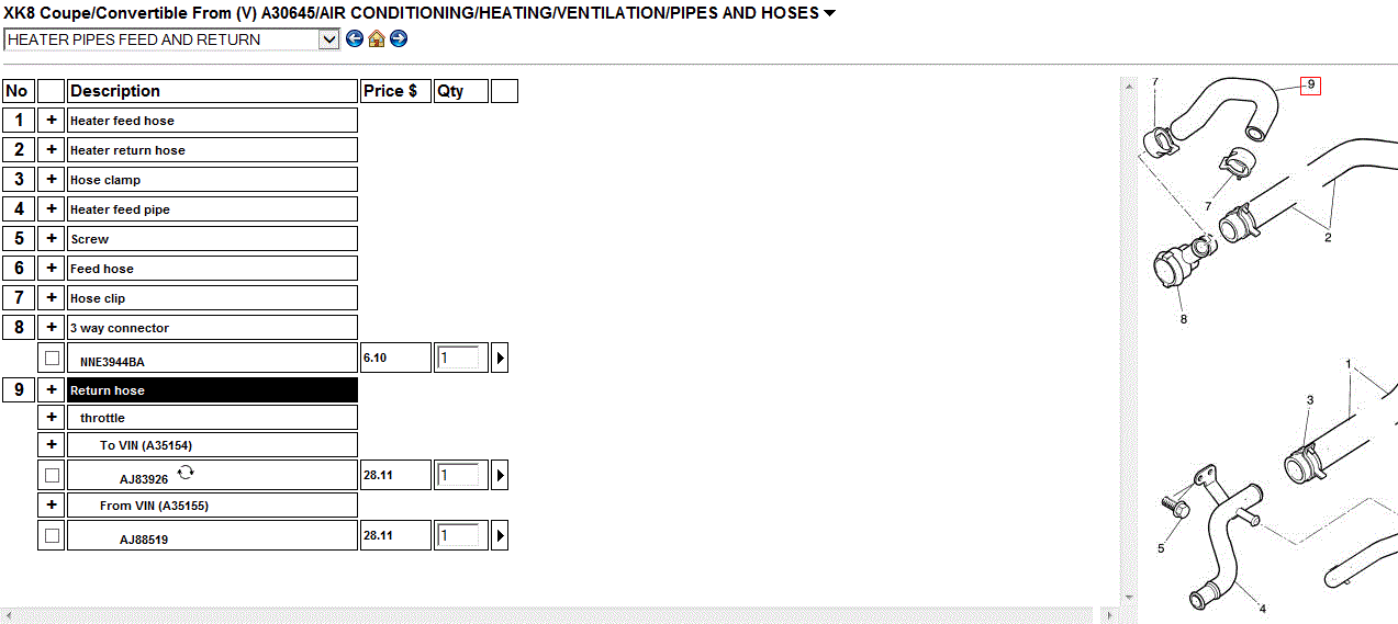

Default Looks like #8

Remove the norma, and attach the hose directly to the metal pipe with a hose clamp. If it's a T, which I think it is, add in a 5/8th (I think, not sure), bronze barbed T, and attach both hoses to it, then another section of hose to the pipe, and you're going to need a few clamps. Problem solved, and will last longer than the Norma.

I keep 3 or 4 THREE WAY CONNECTORS in stock for all my X100/X308 cars.
The resin breaks down after several years and they need replacement.

The actual part from Jaguar or aftermarket sellers is about $5.00 US.
