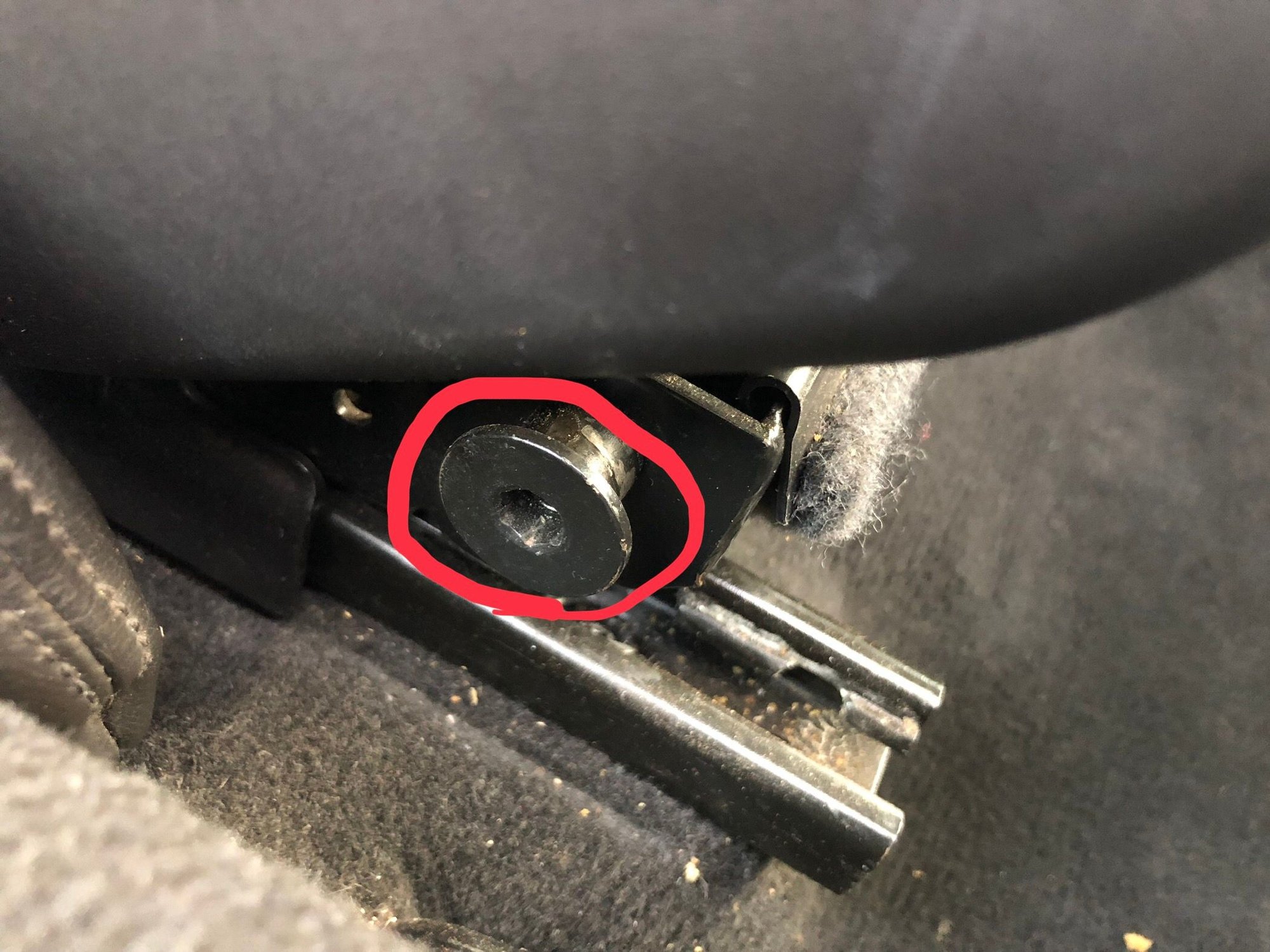

By pegs, you meant this thing?
Old Sep 21, 2018 | 10:57 PM
fmertz's Avatar
Joined: Nov 2014
Posts: 2,675
Likes: 1,578
From: Eastern USA
Yes, those are the pegs (4 total).
