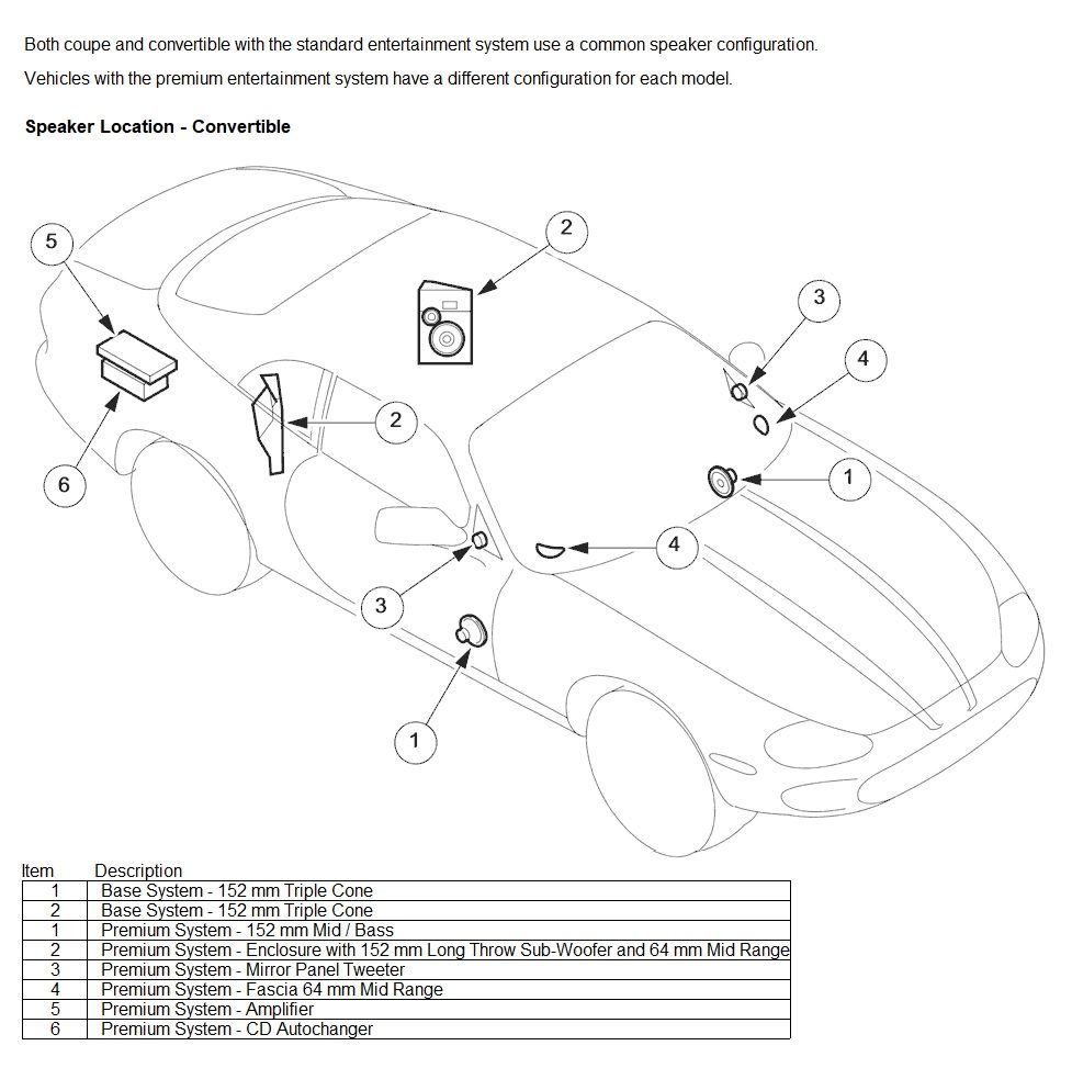

Here's the comparative Standard and Premium speaker setup:
At that point I'll retire from the debate as I only turn a vehicle radio ON twice. When I buy the car to check it works and and again when I go to sell the car to make sure it still works. V8 is sufficient music for me.

I probably should have given a more complete answer.
The tweeter and dash squawker share common wiring - i.e. the two drivers are in parallel. The wiring on the base system ends at IC1 in the centre console.
Base:
Premium:
It would be possible to tap off the door speaker and run wiring up behind the 'sail' and attach a tweeter to that via a suitable capacitor.
