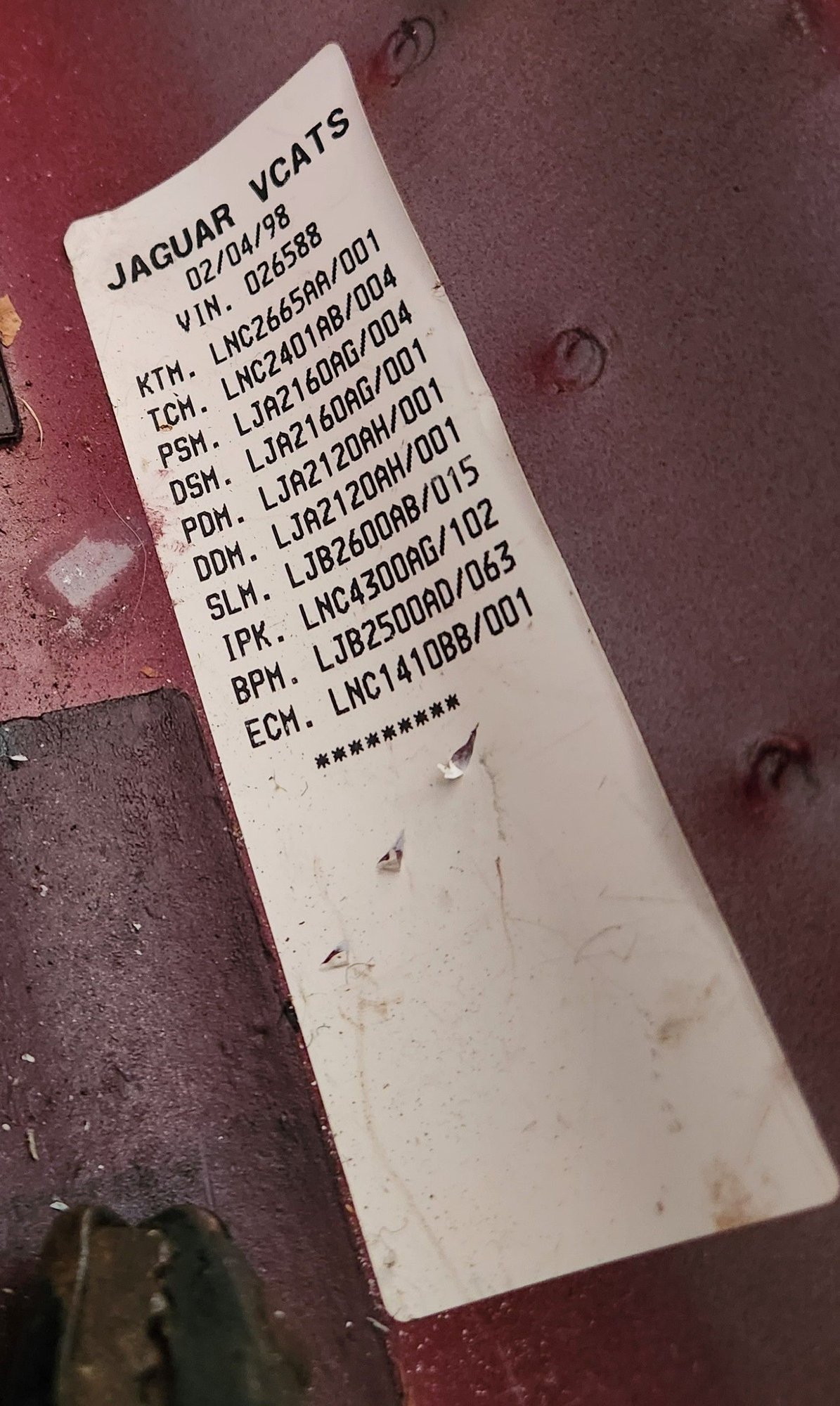

I have a 1998 xk8, dtc 1775 and 1779, if I replace the TCM with a used one, does it need to be programmed?

The VCATS needs to match, that is all.

The label on the TCM is marked with a part number, for example LJE 2401 AB, and a VCATS version, such as 001, 002 or 003. In the photo below, the TCM has version 002:
As long as you replace your TCM with a part that has the same part number and same VCATS version, it should work without reprogramming.

Don ,I found the vcat label in the trunk under the latch. The TCM part number is common on units on ebay except for the 00 number, mine is showing 004, whereas many show same part number but with 004. Is it possible to use one with same part number but different version of 002? I have IDS set up on 32bit windows xp laptop?
Hi Jack,
I will defer to Bob (motorcarman) on your VCATS label, because he knows a whole lot more about VCATS than I do, but rather than going by that label, I would remove your TCM and go by its label. That's the best way to get a replacement module with exactly the same part number and VCATS version as the one that had been working in your car.
It is not difficult to remove the TCM. It's in the Engine Management compartment in the engine bay. Be sure to disconnect the negative battery cable in the trunk before disconnecting the TCM, ECM or any other electronic module. Reconnect all modules before reconnecing the battery.
Cheers,
Don

If you are asking if you can change the /00X SUFFIX of the module...................
I have never tried to change the software. It is configured at the factory and I just match up the suffix.
Some modules with a different part number because of a supersession will work OK.
Something like LNC2401AB might be superseded to LNC2401AC but the /00X SUFFIX still needs to match or things might not work properly.
For instance if you try a sedan or coupe suffix in a 2 door XK convertible with different part number it might alter some variable?
Probable won't damage anything but I have never tried it.

I ordered 18 quarts of trans fluid for the 5 hp 24 gearbox, local shop is going to do the procedure of drain , fill, run 3 times with the last one gets new filter. As for the TCM, you were correct about the numbers not matching, I was ble to photograph the box in place without removing it, numbers don't match vcat, but there are a few with identical numbers available on ebay. I drove the car today and it went into limp home mode, did a scan and it shows tcm fault.....I will let you know the outcome, thanks to you and Bob for your advice...vcat label and tcm label in photo
