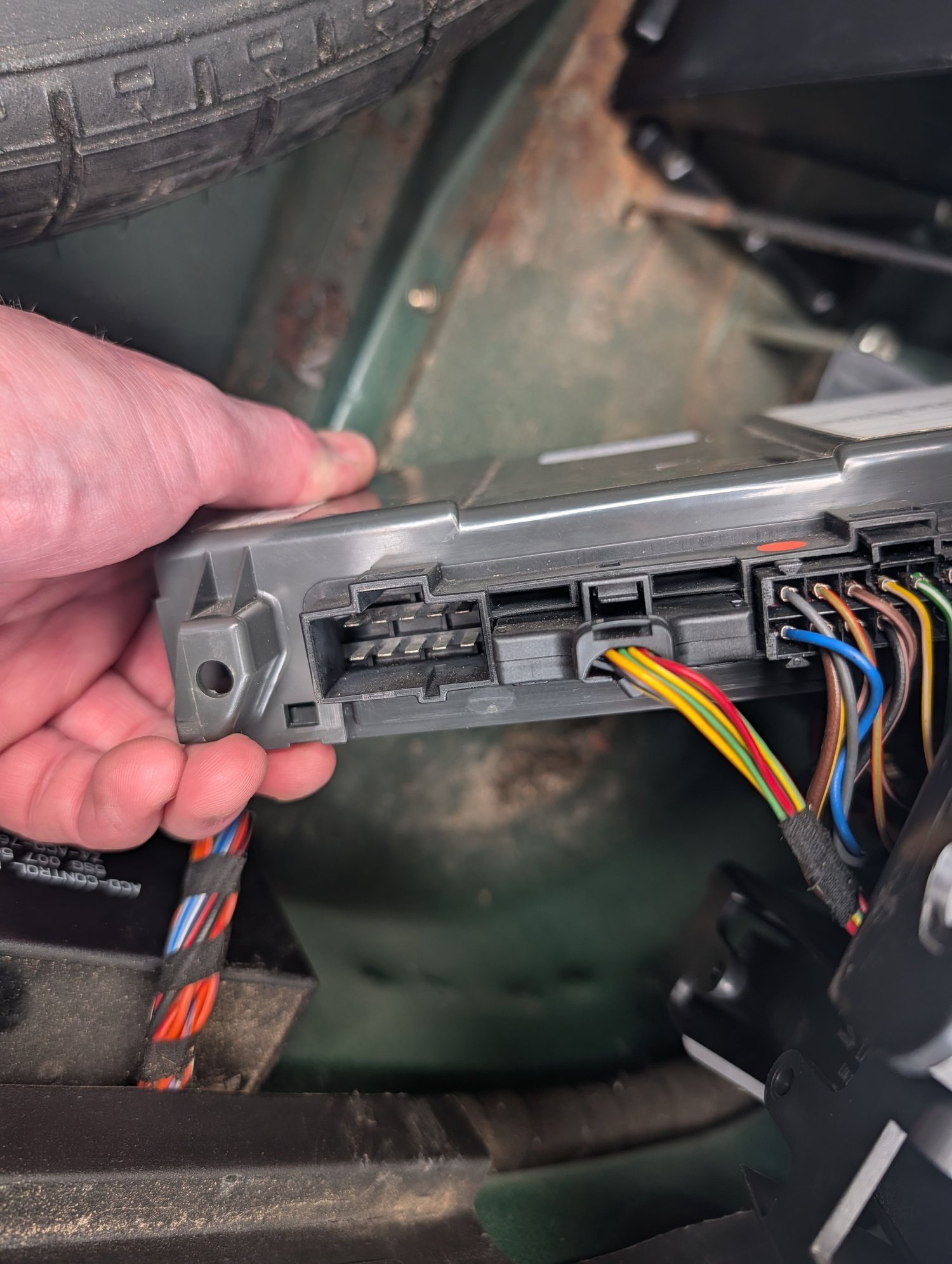

Hi all.
After putting the XKR away in the garage over the winter suprise it has an issue with being unable to start.
Originally the alarm would go off every time I tried so after some diagnostic I changed the drivers door latch and window module plus swapped out some relays and she fired straight up.
Problem is now I have lots of warning massages:
Boot open - it's not open.
Bulb fail rear- the only bulbs not working are the internal ones which did work but no longer do.
Suspension faut.
Restricted performance.
Other issues.
After unlocking the central locking handles open and close several times.
Boot/fuel cap release button not working but did.
Alarm does not go long off, full stop.
Roof open/close switch is dead. Did work fine
Airbag light is flashing but fixed this last year.
Codes showing
P0507
I have checked the SCLM connections and noticed it has a clip slot free, should something be plugged in here?
I'm guessing all of these issues are related so any advice would be most appreciated?
Thanks in advance

I would check ALL the DTCs in all the modules on the CAN bus.

from a hardware perspective, I would look towards the throttle body and vacuum leaks.

Before doing anything else check your battery is fully charged - in particular "After unlocking the central locking handles open and close several times." is typical behaviour when you have a flat battery.
As Motorcarman says, read the fault codes (DTCs) once you have checked your battery. An OBD dongle and the Torque app is the cheapest/easiest way of doing this.
And finally a warning: don't fiddle about with the wiring or any modules before you have done the above - old wiring is like a sleeping dog..
