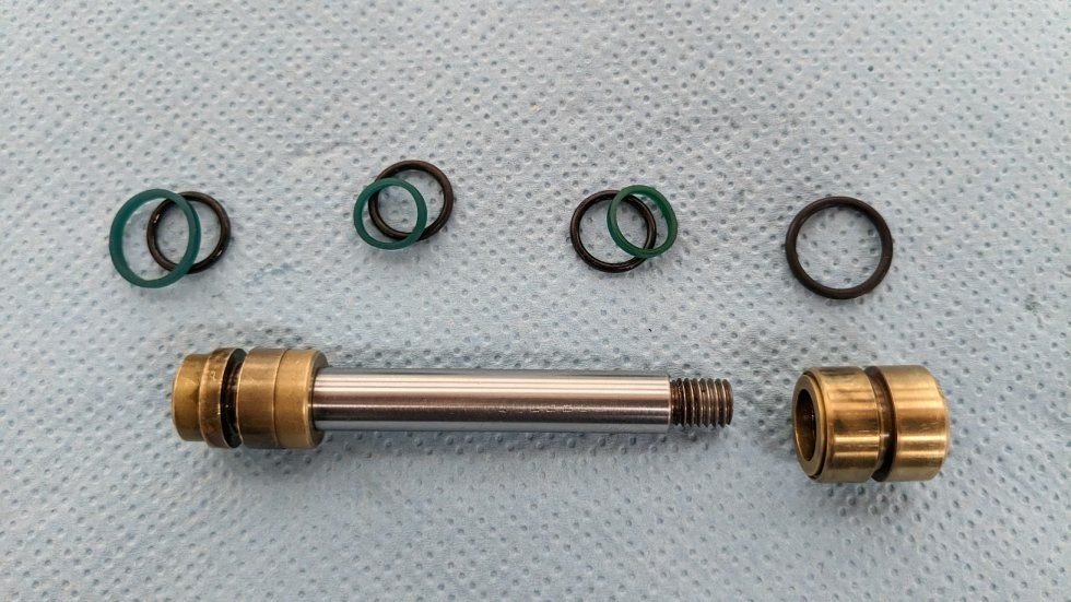

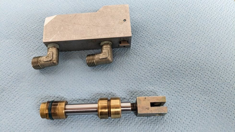

Hi, i can confirm that, based on the description, most probably the seal on the pressure piston in the hydraulic cylinder is leaking.
I had the same problem last year, but couldn't find anyone who could seal the cylinder. A new one is ridiculously expensive (€700+) and almost not available.
I took the latch cylinder apart and sent the seven seals as samples to a company that specializes in hydraulic seals, and they all had them in stock. Replacing the seals requires a bit careful work, but it is doable.
Best, Fritz

Who did you get the new seals from? Do you have the part numbers?

Old Sep 3, 2025 | 11:55 AM
