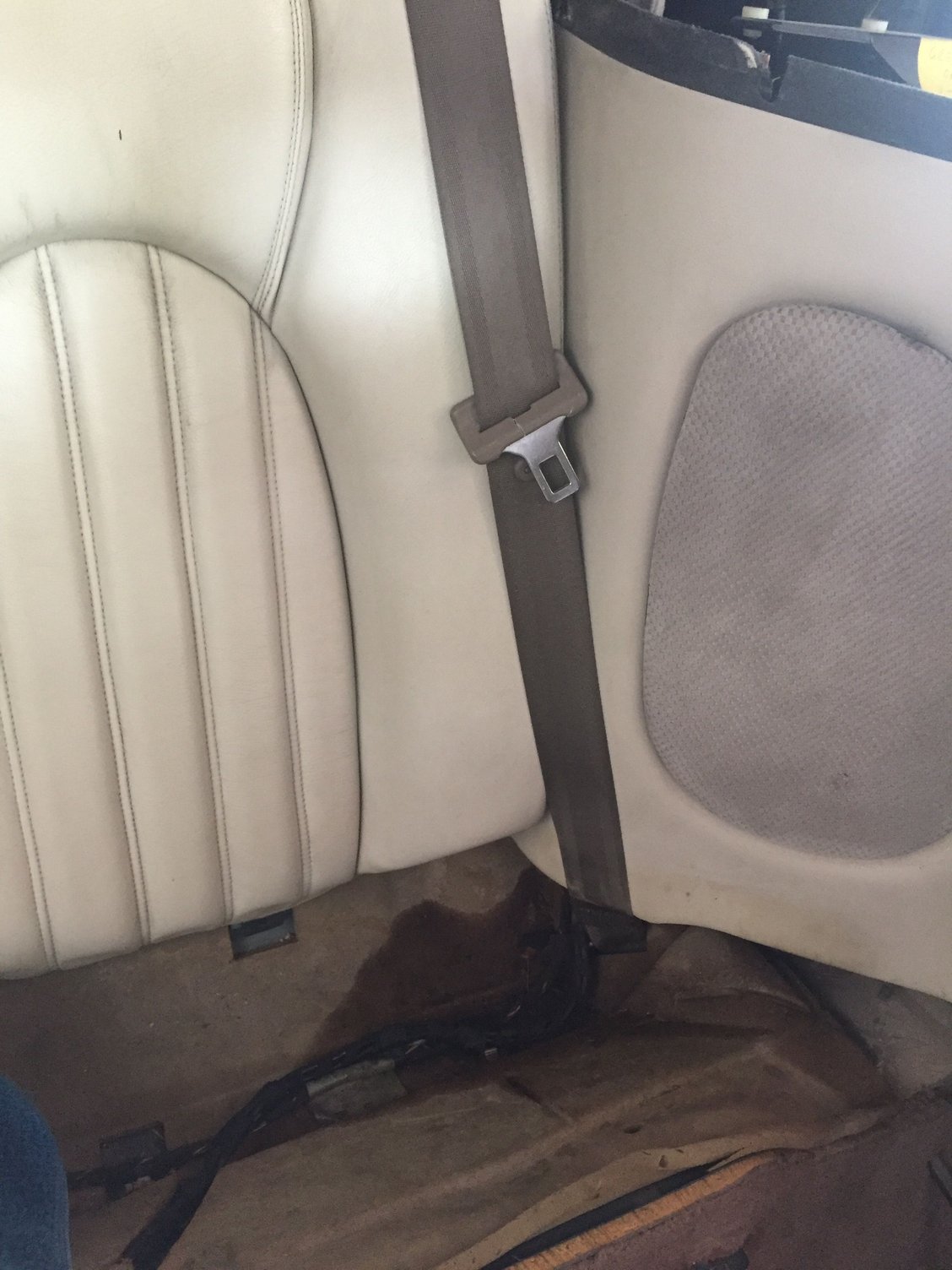

+1 to motorcarman
Here’s where my leak was.

Bone dry on both sides in my case.
