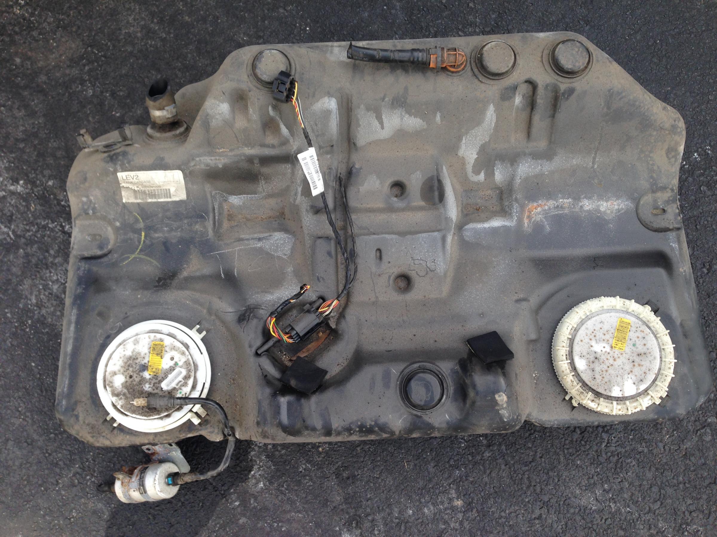

3. 3/8/14 - 3/9/14
*** Got a gas tank ('07 Jag) w/ everything w/ it from a junk yard (waited 3 hrs for it!)
*** Got the drive shaft & muffler to drop (lots of WD40/Blaster & elbow grease); cutted off the bracket holding the muff b/c I could not get the nut to turn (even tried the torch).
*** Dropped the gas tank w/ about 11 gallons of gas still in it (w/ the help of a few jackstands) - had to cut the "fuel filler neck hose" b/c the clamps on it totally rusted out.
*** Ordered the "fuel filler hose"; will try to put everything back next week!
I want to say thanks again (got a few tricks & tips from this forum).
4. 3/15 & 3/16 - managed to put everything back as is but still no power to gas pump. Ordered a fuel pump module to swap out just in case.
***Notice someone (mechanics) has messing around w/ the module and didn't bolt it back in. Can't wait until the module arrive. I think this is problem!
