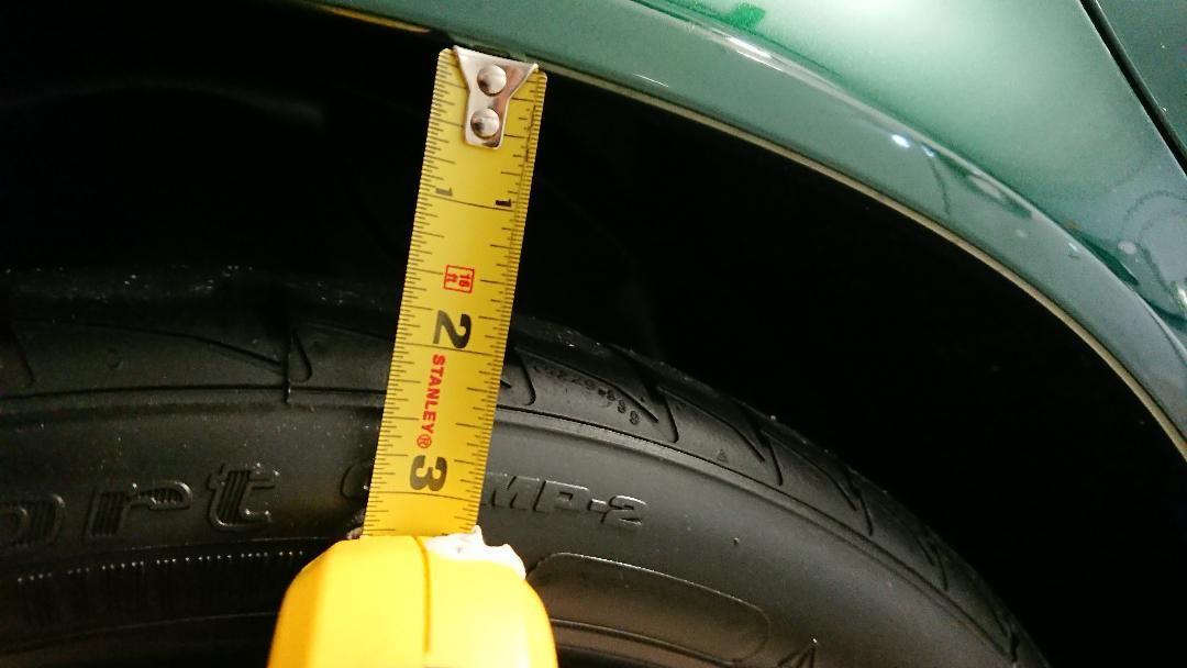

Thanks for the information Scott, i'll attach a couple pictures with this post. Not sure if they show anything its much easier to see the difference in person. lol
Left Rear tire
Left Rear tire
Right Rear tire

The photos dontd show much...I am thinking the rear anti sway bar bushings...take a good look at those...do you hear or feel any low speed thunking or clunking at the rear...on dips...potholes...even on a driveway...I am pretty sure there are adjustments that can be done for the rear suspension...not sure what they are besides the toe in and if any affect ride height...have you had an alignment done recently
I was never good at taking pictures lol, I last had a alignment done in the late spring of last year they checked all 4-four wheels. I don't hear any clucking or strange sounds at the rear.... not even in the driveway lol.
