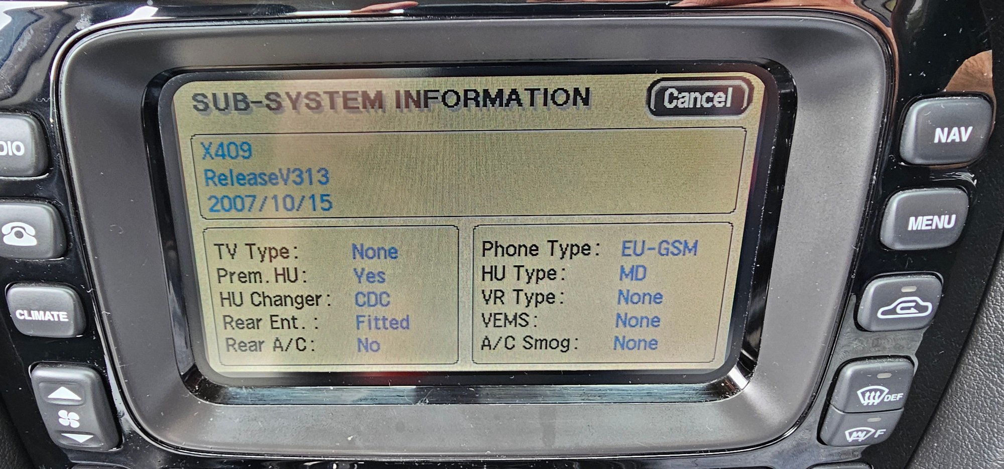

I know of the hidden menu (press phone + menu buttons, type 1971),
This isnt my screen, but it looks like this (showing x400 on top left)
when you select 'misc' its lets you select from X400, X350 or X202, I select X350, getting my dual zone options back however as soon as I restart the car, it doesnt save and goes back to the X400 menu

What makes this even stranger is when I access diag menu via code 1971, and select 'misc' -> 'system options' - I can select 'X350' (sorry for bad pic)
and it restores all functionality for an X350. However as soon as I restart, it reverts back to the X400 options

I suspect the problem is the code in the NAV unit and I think you can't reload that using SDD. But it may take its config from such as a VID block in which case it's a setting (somewhere...).
