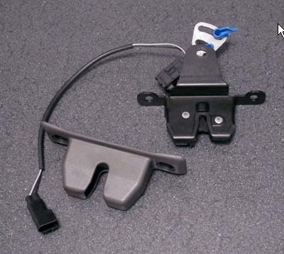

He could have drilled a small hole under the licence plate if he knew where the lock mechanism latch release is located.
Look at these 2 JPEG images of the boot lock mechanism latch Photo and diagram:
Jim Lombardi
Attached Thumbnails Boot Lock-luggage-lock-parts-4-3.jpg   Boot Lock-luggage-lock-parts-4-2.jpg

Thanks for that Jim. The two connecting rods, numbers 4 & 12 had fallen off that shiny fan bracket (6). The hole he cut was just in the right place, which would have been dead in the middle on the registration plate. Thanks Gus.
