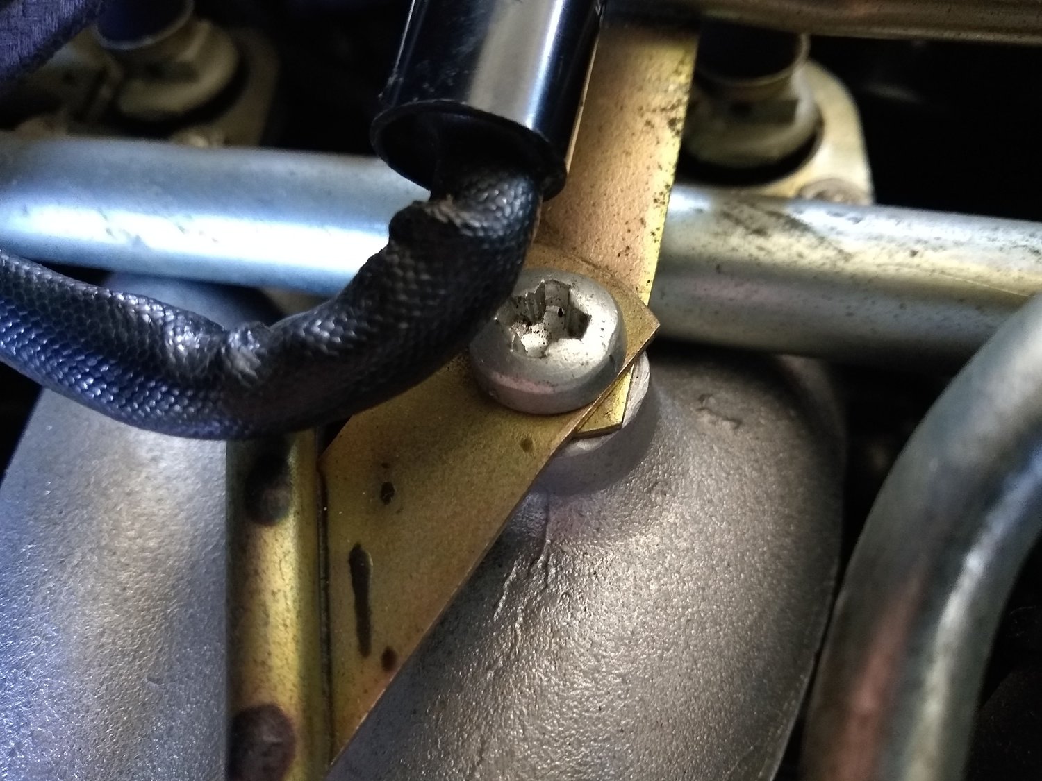

I'm in the process of getting prepared to replace all the rubber fuel lines under the hood on my car. It looks like a phillips head but I have never seen one of these type screw heads before, and certainly don't have a Phillips screwdriver that big. It looks to be something I don't own, and will need to get.

They are referred to as POZIDRIV (a registered trademark of the Phillips Corp).
Should be a #3 or #4 POZIDRIV?

Yes, clearly pozi. Just about everything on a Jaguar that looks like a phllips is actually pozi. The usual way to tell is there is a hash mark at 45 degrees, but I don't see it on this head. However, the small cut-out at inside of the cross indicates it's a pozi

All pozidrivspozidriv thru #3 are in the hex bit set that Harbor Freight sells for $10. The set is in a red blow-molded case. They are also in the long hex bit sets at Harbor Freight.
The #4 size you'll need to get separately. Try eBay, https://www.ebay.com/itm/161938444559
Don't use standard Phillips screwdriver a on any original fastener on your XJS. You'll round them out. Get used to only using pozidriv bits.

l think it is actually a pozi drive screw. Not sure which number. You may get it with something close if you give it a rap on the head beforehand.
vice grips will loosen it with little to no damage if you want the easy way out.

PH is Phillips, PZ is Pozi.

Those buggers are always stripped! And the steel loves seizing in the aluminum. Must be a PZ4 because I have set PZ0-PZ3 and it wasn’t big enough. Ended up getting a giant Phillips impact screwdriver at Harbor Freight to break it free.

Where ever possible I change the giant pozis to hex headed stainless bolts. Highly recommended.

I have removed mine and slung them in the bin. Replaced with a new bolt. They seem to be made of cheese I tried with a screwdriver and the head just mashed up so removed them with a pair of mole grips.
