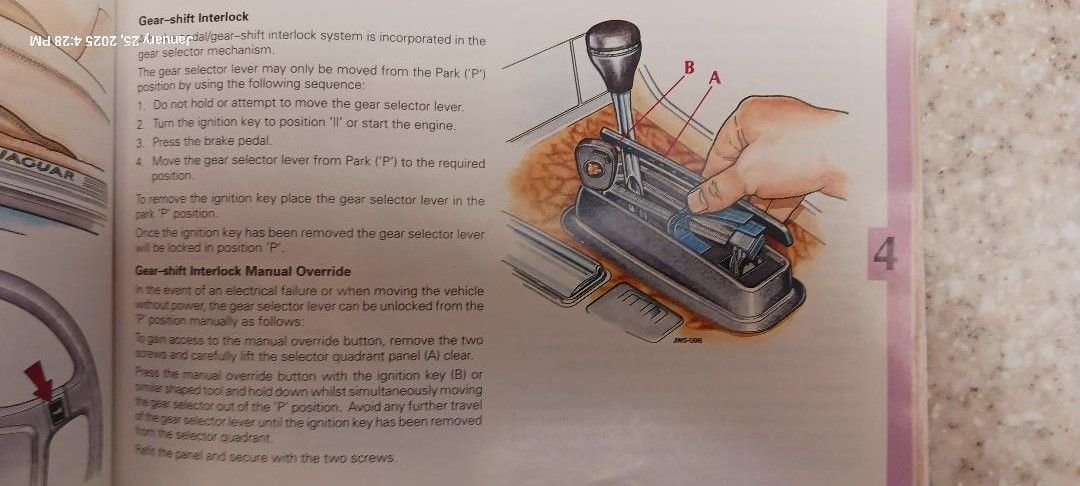

The solenoid for the Park release is under your shifter console (ski slope) at the very front. In an emergency, you could remove the ski slope and operate the release mechanism. My 95 occasionally does the same thing so let us know if you figure it out.

That’s great information. I have removed the wooden panel but I do not see anything at the front. Do I need to remove the entire console to access it. I really appreciate all of your help.

When it works, you should be able to hear the solenoid under the panel forward of the gear shift handle at the front edge of the panel. You do not have to remove the console.

Old Jan 25, 2025 | 03:35 PM
RickE's Avatar
Joined: Apr 2016
Posts: 209
Likes: 91
From: Southwest Florida

So helpful!!! Thank you so much. I hope that it is the problem because I am 70 and not as limber as I used to be to get under to the brake pedal switch. I keep forgetting that it has been 25 years since I restored my E-Type.
