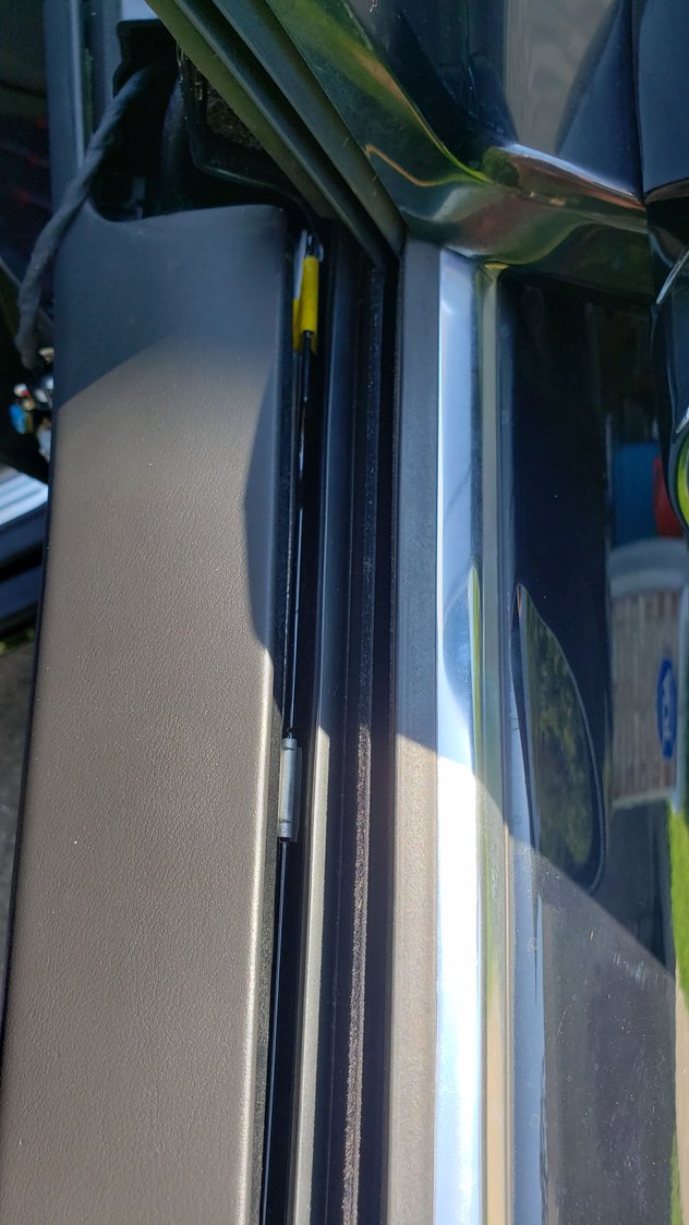

I did wonder, however if you (or someone) could give me some guidance on this. Along with the broken mirror cover, it looks like they did not place the door panel back correctly. I hate dealing with interior panels - clips and things always seem to come loose or break. I don't want to tweak this the wrong way and break anything.
How can I get this door panel back into its proper place, where to I need to push, pull, lift, etc...?

Looking at a picture - it does not fit properly now. Well - you can put it correct, but I definitely cannot describe this process over a forum post.
You will need a metal tool - special screwdriver for clips (sorry for my poor English vocabulary). Using it - you can only press clips into a door panel. As it is more from this side.

Best to remove the panel as described in the service manual (see stickies where you can download it if needed). I have a 4.2L but believe the procedure is the same or at least similar.
Most likely is whomever removed the panel before, did not remove the wedge clips from the panel (they usual stay in the panel when it is removed) and place them on the metal door rail (which you can see in your picture) before mounting the panel. There are two guide pins on the panel that align with holes in the door and very hard to lift the panel to match the guide pins up AND slip the clips on the door rail with them on the panel at the same time which is why your panel is not on correctly.
Easy fix, If I can then you can do this.
- Remove the mirror inner cover carefully but yours is already broken.
- Remove 3 torx screws, 2 under door handle, 1 under a small plastic cover at top back of door panel. T30 I think.
- Use a plastic panel pry bar, start at bottom rear of the door and pop the panel push clips out gently as you work your way around the the bottom, front and back of the panel. The push clips are a couple inches in from the panel and about 9 of them. If you break one, easy to find equivalent ones at NAPA or another good parts store. Just take one with you to match up to a replacement. There are a bazillion types and sizes of panel clips.
- Lift the panel off pulling the panel bottom away from the door as you lift. There are one or two electrical connections to remove as well as the Bowden cable for the interior door handle.
- Pry out the top clips that are stuck in the panel and transfer them to the top rail in the door. There are little notches in the rail that the clips slip over. 6 top clips total I think.
- Reconnect the electrical connections. Install the Bowden cable barrel in the door handle and the cable sheath has a groove that slips into a notch in the plastic part of the handle assembly.
- Align the panel with the top clip “wedges” with slots in the panel and press the panel on. The 2 guide pins should self-align when the top clips are pressed home.
- Press the side and bottom panel push clips in working from top to bottom. I give them a firm push with the heel of my hand.
-Reinstall screws and cover. Check door opens and all control buttons/lights work
- Reinstall the mirror inner cover.
Good luck.

When I bought my 2014 the drivers side door card was not properly re-installed from the previous owner having the actuator replaced under warranty. Remove the door card enough to start the re-install from the top so in fits in tight toward the window. Push down on the top then work towards the bottom. Be very careful removing the speaker it is very easy to break the plastic fastener.

a minor tip. The clips were probably there since birth. Once you get them off, put some vaseline on the clip and the body. It will make the install much easier. That's probably why the tint shop failed. I struggled with mine but once I put the vaseline on, it slid on smoothly.
