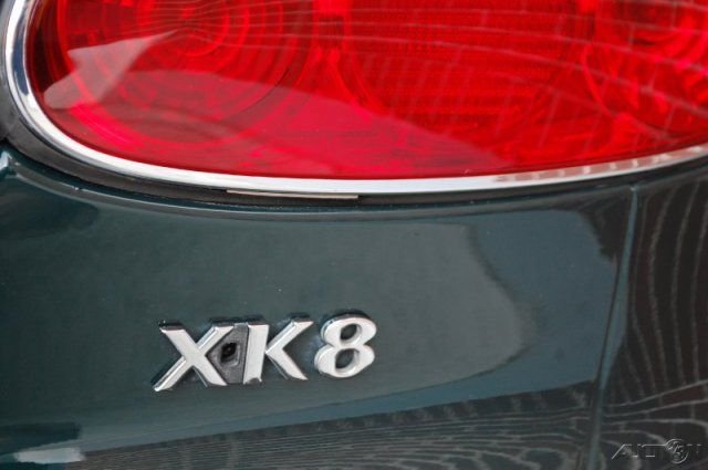

Put the key in the boot opening slot next to the XK8 sign at the rear. Should open the boot.

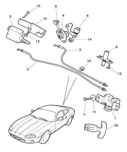

With the battery OUT the vehicle, you can't use the method of powering from another battery connected to the engine bay terminals to energise the circuit as it is incomplete. The only solution is the keyway in the luggage compartment lid which is a direct mechanical link to the lock.
You don't mention Coupe or Convertible but the locking mechanism is the same and neither have access from the passenger compartment through the rear firewall to the luggage compartment.
The Lock (item 1) is normally opened by the electrical Actuator (item 3) pulling the Cable (item 2). The alternative of the keyway is physically rotating the Lock Barrel (item 4) pull the second Cable (item 5) to open the Lock (item 1).
If the Lock Barrel is seized and cannot be rotated, a more destructive method would have to be considered.
