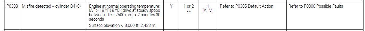

Now, as our eminent GGG likes to say "As this is a Jaguar, nothing is simple." I attach a PDF showing the various ways Jaguar has referenced the cylinders (taken from one of GGG's numerous posts).
As for your misfire, please find below the relevant excerpt from the DTC book.
As you recently changed out the spark plugs, I would guess that the wiring loom/coil might be damaged. They're old and crispy now, (and FWIW I'm considering changing these wiring looms in my next service.)

I would swap coils between 7 and 8 to see if the misfire moves. If it does, replace the coil. If it doesn't, that may point to wiring damage as David suggested.
If I recall correctly, you have the the cylinder numbers correct. I did a ton of swapping/testing on that side when I was getting P0307 and P1316 intermittently.
