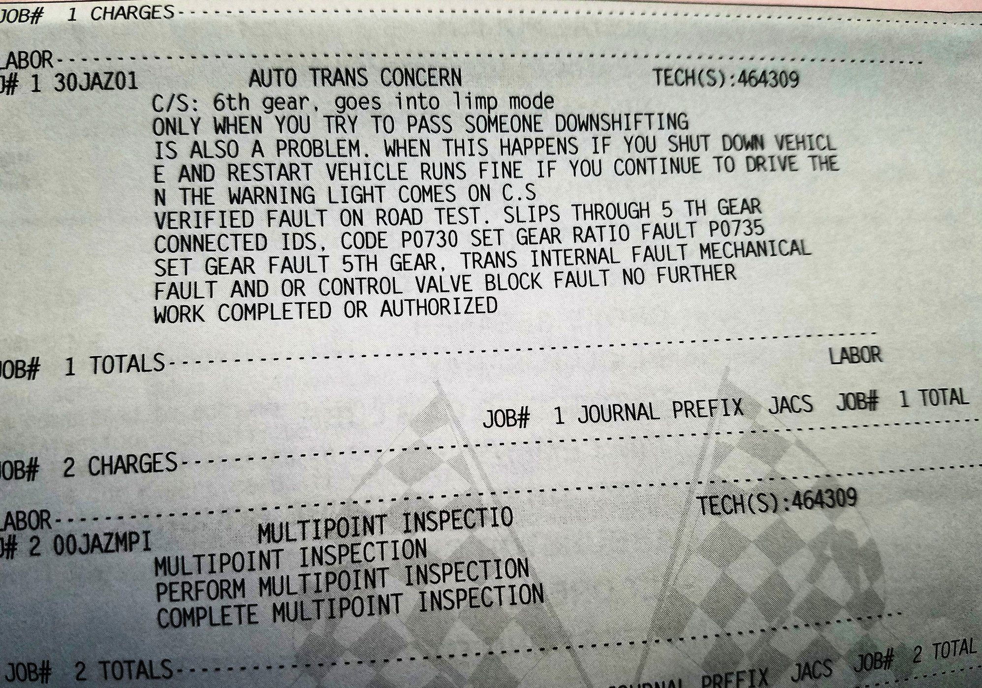

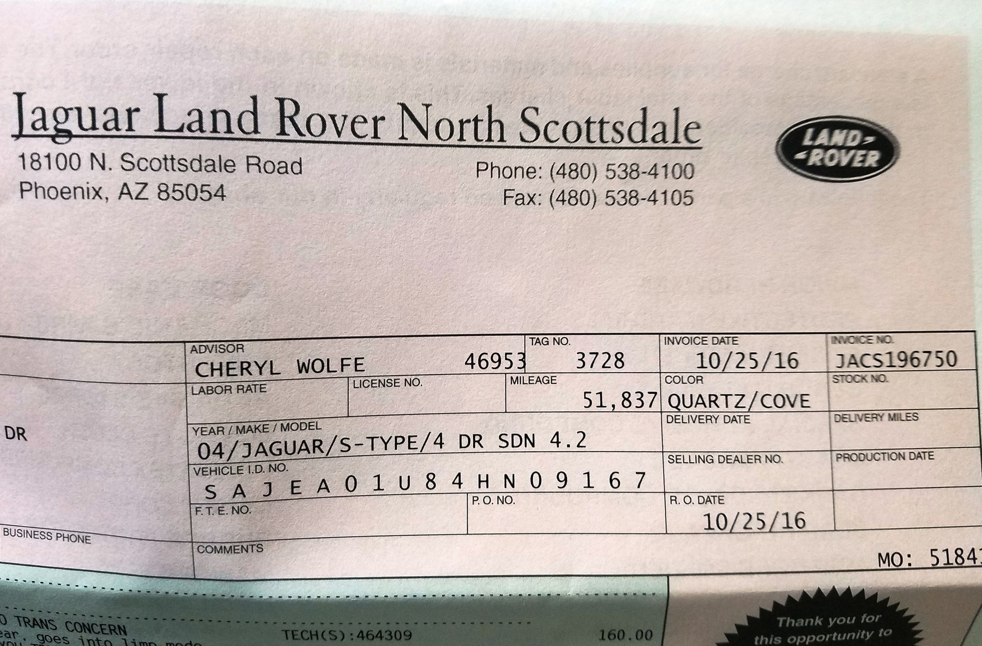

Finally took car to Jag Dealer for service, and I feel I had a Huge waste of time and money, As they told me afterward they don't do any real repair work on the Tranny, and if their's a problem they only swap them out (at $10k), To make matters worst, they told me I had no 5th gear, and they test drove it to verify, My dad asked twice about this point, and wanted to hear explained, how when you use J-shifter or sport mode you can verify with Tach it up shifts to 5th gear, if you shift out of J-shifter or sport mode, Into normal drive mode it switches to 6th gear, you can go back and forth down and up verifying.
Now in normal drive mode it does switch rather quick from 5th to 6th gear, unless you are hard accelerating from a lower gears then it holds 5th as it revs to 6th, My dad tends to think its just saving fuel, but the service tech told the service agent rep we had no 5th gear at all, and it was going from 4th to 6th,, We couldn't question them directly on this. or ask for a ride through to show our concerns. So what do you think?
Our Ppwk States more than what was said to us, the main points as follows (See photos)- Slips through 5th gear connected IDS, code P0730 set gear ratio fault P0735 set gear fault 5th gear, trans internal fault mechanical fault and or control valve block fault
I take it your not happy with Jag dealers!
Lets go back to the beginning.
are you still getting the delay when moving into reverse?
Did the shop you took it too for the transmission and fluid change correctly refill the transmission?
Did you have an oil leak from the transmission, to begin with. The sleeve O rings tend to go and cause leakage of transmission fluid.
Have the transmission level checked by someone who knows what they are doing.
You state you do have 5th and 6th gears sometimes.
I would clear the transmission adaptation and check you have the latest trans ecu software, which may(will) require a visit to your friendless Jag dealer.
If you speak nicely, they may give a discount, or look up on the vin no. for the the service history on the car and tell if this has been done in the past.
All the above, fluid level check and clear adaptation, and confirm latest trans ecu software. are the cheaper options.
from there on things could start to get expensive
Good luck.

I asked the Jag dealership to check to see if I had latest software updates, they told me they only had updates for newer Jags,, after 2009, ( I had bad feeling from that point )so couldn't confirm latest trans ecu software, as they are the only dealer in Phoenix area you can see how I felt, $160 was for nothing. I told them I got scanxl pro last month for my OBDII reader, and knew the error codes just not sure what it ment.
Also after summer Lifeguard 6 Fluid change, no more reverse issue, and no leaks,, totally dry from all viewing angles around trans, after talking with a few shops, one stated sport and J-shift modes force more pressure on tranny to shift, but there may still be a problem in normal drive mode. to be honest almost everyone gives a different opinion, and most want several hours dropping trans and looking it over, to hopefully tell me, what the problem is. You get to the point of not knowing who to believe and seeing a lot of money getting used up in process, I found this info web page - Common Problems Associated With The ZF 6HP26 Automatic Transmission..., in 2001, it was the first 6 speed automatic installed into a passenger car, While the ZF 6HP26 automatic transmission is a strong (440 ft-lbs capacity) and well-built transmission, there are still some common problems.....(a lot of them)
After reading more I decided to go a remanufactured route.
As re-manufactured ZF 6HP26 now include modifications and upgrades designed to make them more durable and address some issues early model units have, at least I hope so thanks if you have info on tranny removal please pass along.
