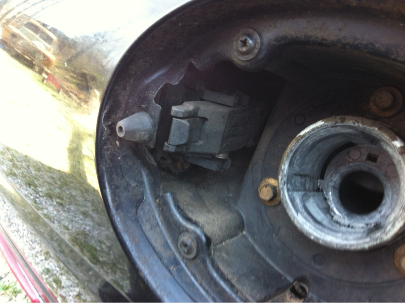

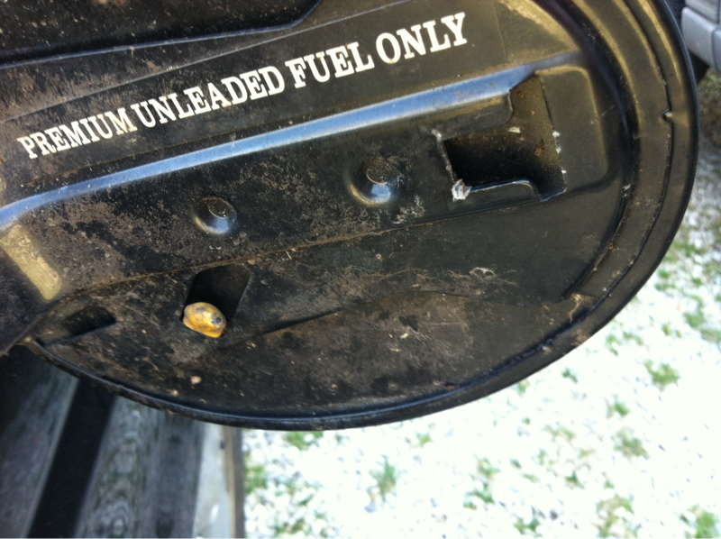

K I've seen several posts about the little pin that breaks off for the door.. Well looking at mine I see no such pin.. Here is a photo of the mechanism and the door.. It won't close but I do not see where a pin there would help?

Looks like mine (well, sort of mirror image but then mine's RHD).

Am I missing a part on the door? I do t see where it latches there is too much space between the lock and gas door
You need to order part # XR818050 (Plastic part that slips onto the metal notch on the gas door) - the one with the "premium unleaded" label. (Yours looks to be totally missing) I keep a spare one handy as I had to replace it not too long ago...

thank you, that is the part i need. i guess previous owner lost or broke it. is there a ford cross reference number so i can go to ford dealer? wasnt sure if the lincoln ls has something similar.

When you get the part - put a bit of white lithium grease on the rails that will slide into the metal notch - take your time and the tang will lock the part in place to give it perfect alignment with the catch mechanism.
Just always close the gas door carefully moving forward.

it looks like your also missing the screw on cap

Looks like I need the same piece. But looking at the pic (which looks just like mine) and a pic of the part from terrys jag, I don't see where the piece would fit. Anyone mind taking a pic of what a working door would look like?

got it today, put it on, i have a closing door. it took 5 seconds to put on, not including the time it took me to flip it around because i put it on backwards...
