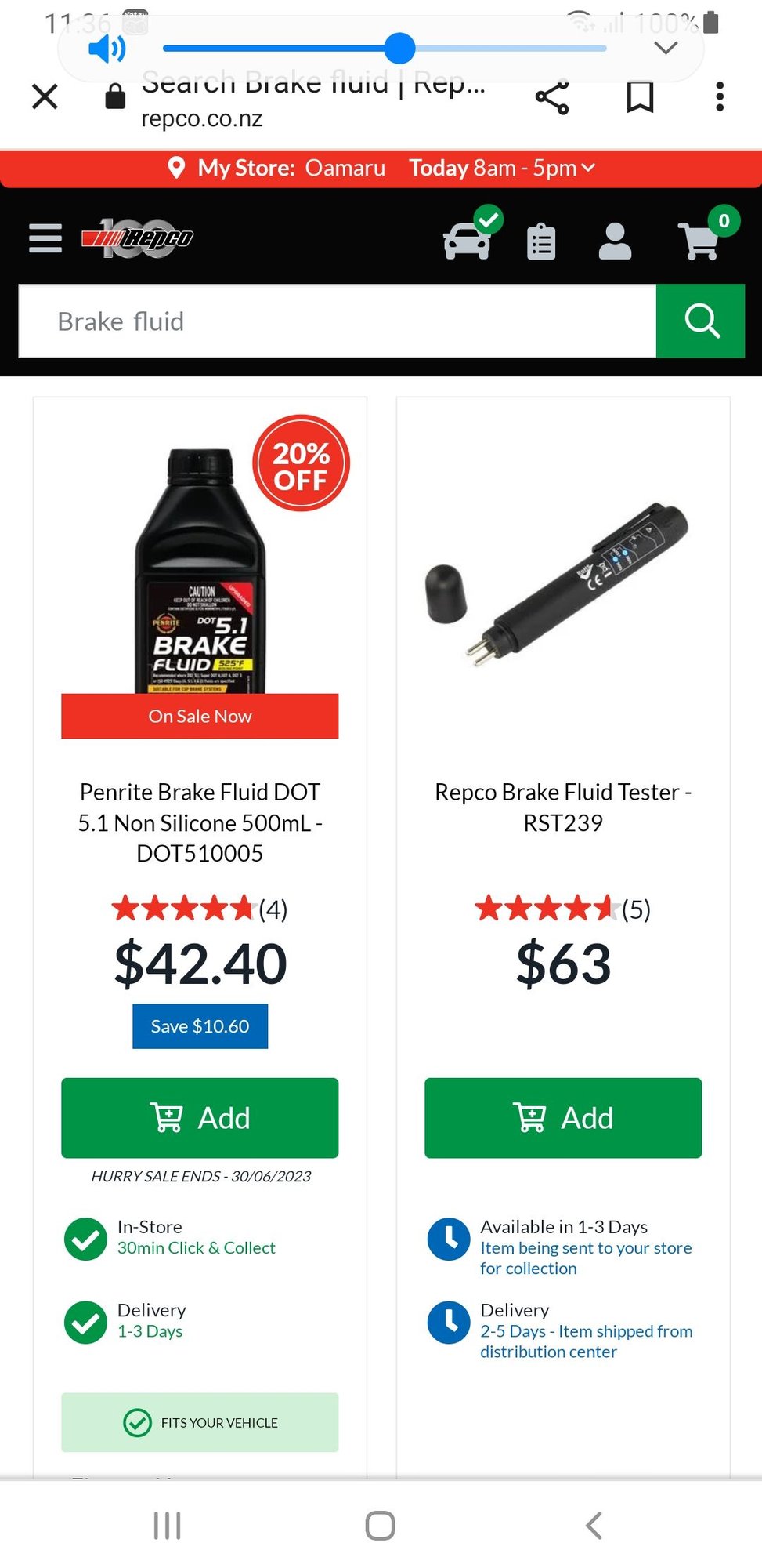

Hello everyone
just done engine oil change from running in oil after rebuild
transmission top up
But noticed brake fluid was low
Phoned our local parts store only one in our town
They told me my s type takes dot 5.1
even on there website it say that
I don't want to purchase the wrong fluid
so thought best to ask the forum
I am heading away in a week
I do have some Castrol dot 4 at home which I used on my trailer
The photo of the Penpenrite Is what shop is telling me I need to use
and is only one available at the moment
If I need to find some else where I will
Just need advice
Thanking you
Darrol

Yes the DOT 5.1 is a new and improved brake fluid that is fully compatible with the older DOT4 stuff. But you shop is wrong Jaguar did NOT specify that fluid. As posted above in your owners manual you can find what they want and it's DOT4.
But since they are compatible it would be fine to use DOT5.1. As you know do make sure it's NOT DOT5.0 fluid! That is way different and can't be mixed as it's a Silicon based fluid.
hi when i phoned auto shop they did number plate search
and what they told me was the only brake fluid they had was penrite dot 5.1
I could not look it up in drivers handbook as i don't have it any more as a friend Borrowed it a couple of years ago and I never saw it again
this is where I got confused as I thought jaguar used dot 4
ESA-M6C25-A
But shop has no dot 4 non silicon based fluid

Yes that Penrite DOT 5.1 will be fine. Yes Jaguar does specify DOT 4 for your car.
The only Silicon based brake fluid is the DOT 5.0 stuff so stay away from that one for sure. All the others will mix fine. I probably will start using DOT 5.1 after my jug of DOT 4 is gone.
It does seem to be a better brake fluid.
