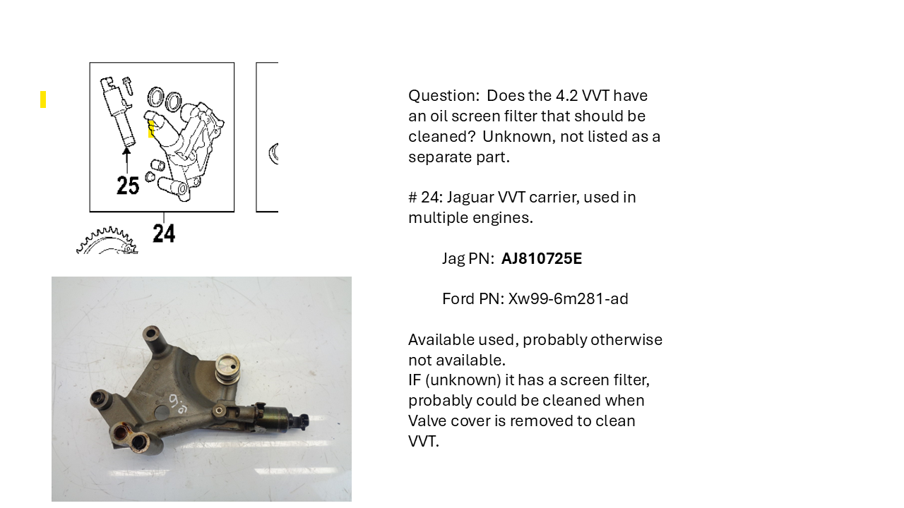

Much later, after I was questioned on existence of VVT oil screen on the 4.2 A:
  1. Cleaning the VVT on the 4.2 NA requires removing the valve cover.
  2. The solenoid bolt is removed, and the VVT solenoid can be removed for cleaning or replacement.
  3. The solenoid carrier is then available for cleaning if needed.
  4. There appears to be no Jag PN for a screen in the VVT solenoid carrier, at least any longer, so AFAICT, the number above is no longer valid.
  5. The carrier itself may not be available new from the dealer.
  6. Can't see if there is a screen filter for the unit (as there are on the BMW's for instance), in any of the pictures.
  7. If there is one, can be cleaned when cover is off.
  8. probably better searched by Ford PN since it's stamped on the carrier.
See below upload for PN's.
Panthera

That's really helpful information, thank you Panthera. Do you (or anyone) happen to know where the screen would be in the module carrier? Like, is it easily seen or does the carrier have to come off? Trying to weigh up whether or not to go through the pain of taking the valve cover off to try and clean the screen and VVT solenoid.
